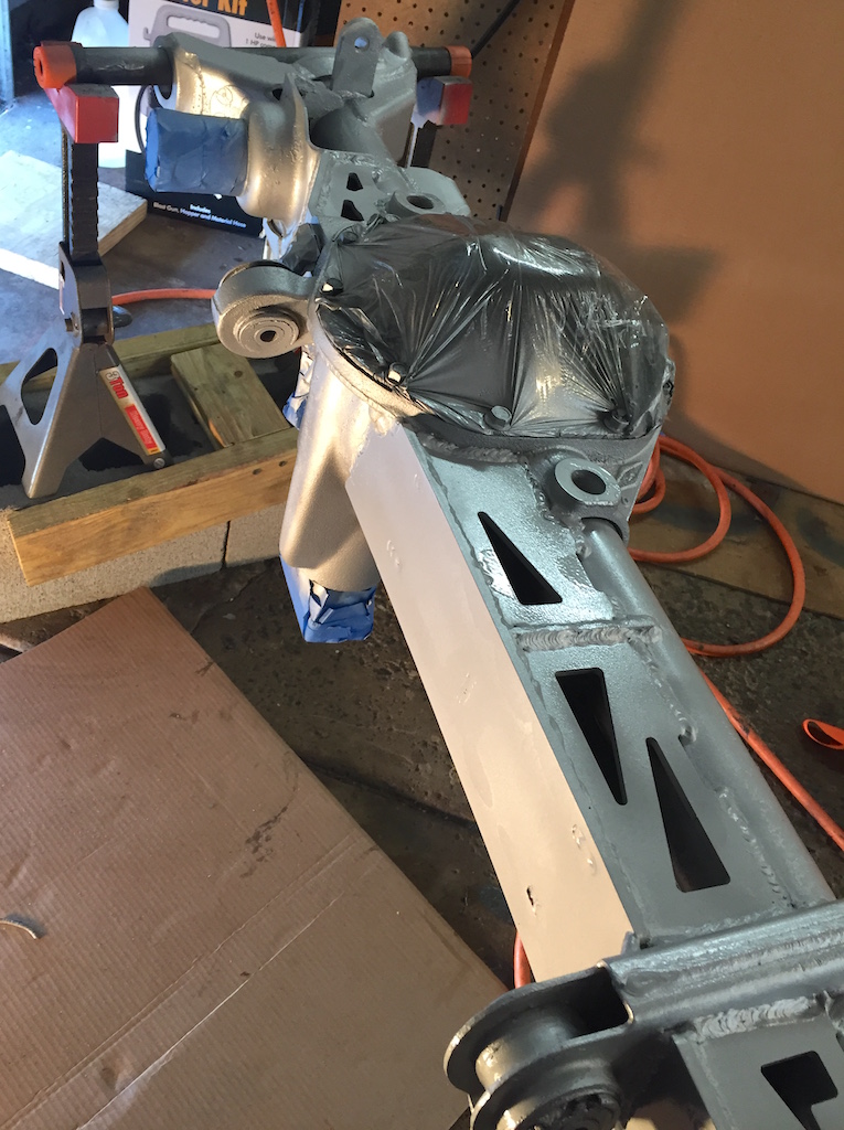

Originally Posted by Biginboca
My Artec truss was hitting my front trackbar bolt at the frame mount. This was with 3" front bumpstops. Part of this depended on what length I had my lca's set at. But to get 4 degrees castor with stock upper arms I needed to notch a small area of the the truss about 1" long x 1/4" deep. As far as I can tell this was the only area it hit anything on my 2011 JKUR. I probably could have just reversed the bolt but it was faster to just bust out the grinder and some spray paint, lol...
I would argue your statement of "faster". I have the bolt on mine facing forward (opposite as you) and it's just fine.

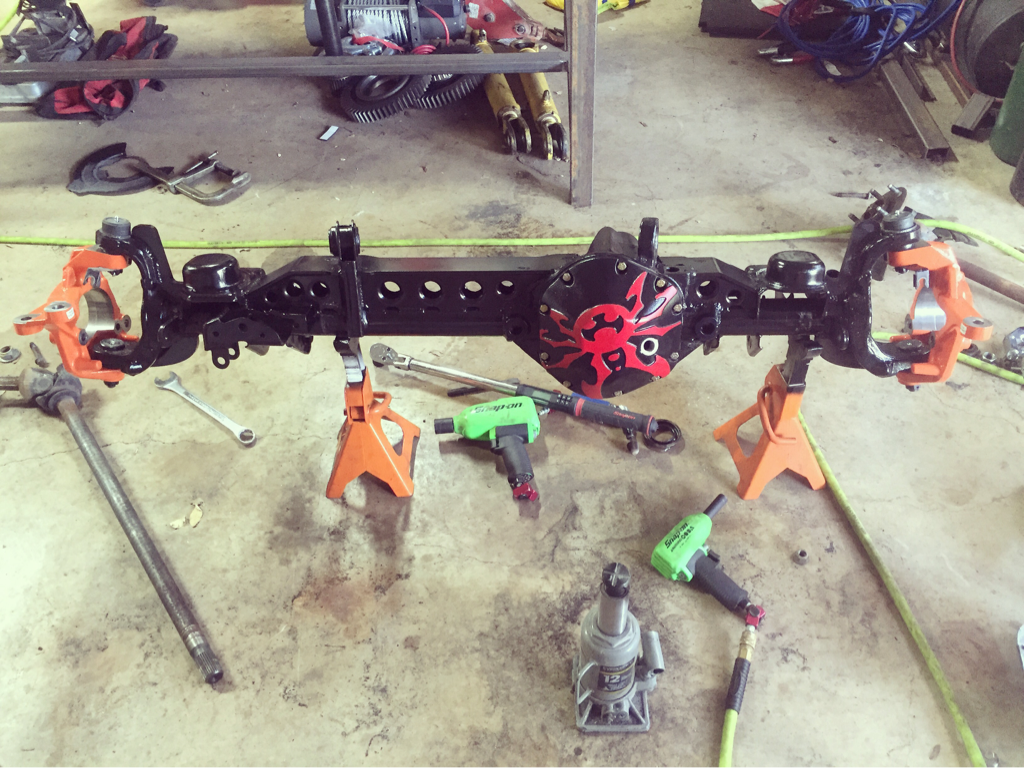

Originally Posted by DROELLE
TMR truss. Great tight fit no clearance issues. Sent from my thread killing iPhone
Looks pretty much identical to my artec

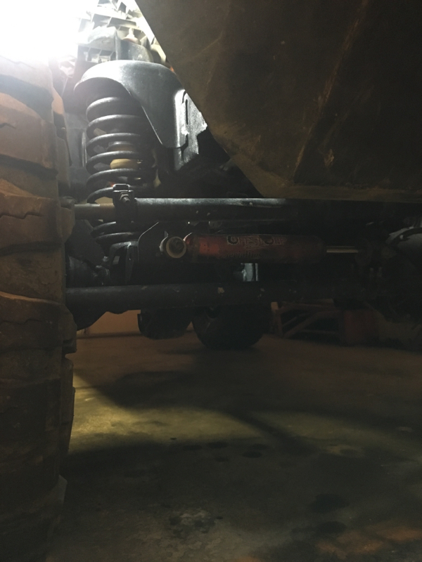

Originally Posted by ShutterBug
I like my Barnes 4WD truss. <img src="https://www.jk-forum.com/forums/attachment.php?attachmentid=656271"/> 1/4" and 3/16" steel. No whimpy 10 gauge stuff here!
I'd be more worried about ringer's welds cracking on ya again lol just playing.
