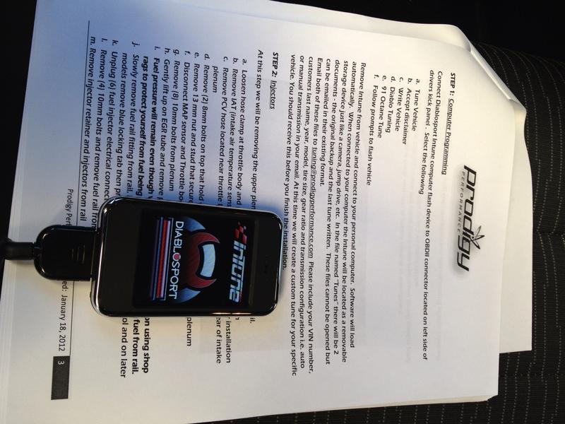

Default OEM tune sent off for 12 psi tune
Using the inTune I downloaded and sent off my current tune to be upgraded to a 12 psi tune, which I will need to have in hand before I start this project...
