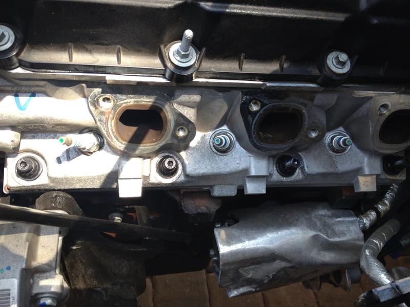

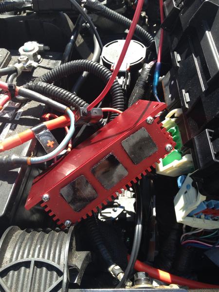

I got the boosta pump installed and 4 of the head studs. Slow going but with any luck ill be done tomorrowClick image for larger version

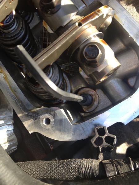

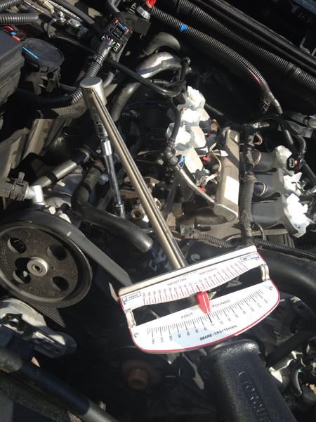

Old Mar 29, 2013 | 02:34 PM
  #44
Captaincalf's Avatar
Joined: Oct 2012
Posts: 109
From: Lithia, FL
Default Day 1 continued

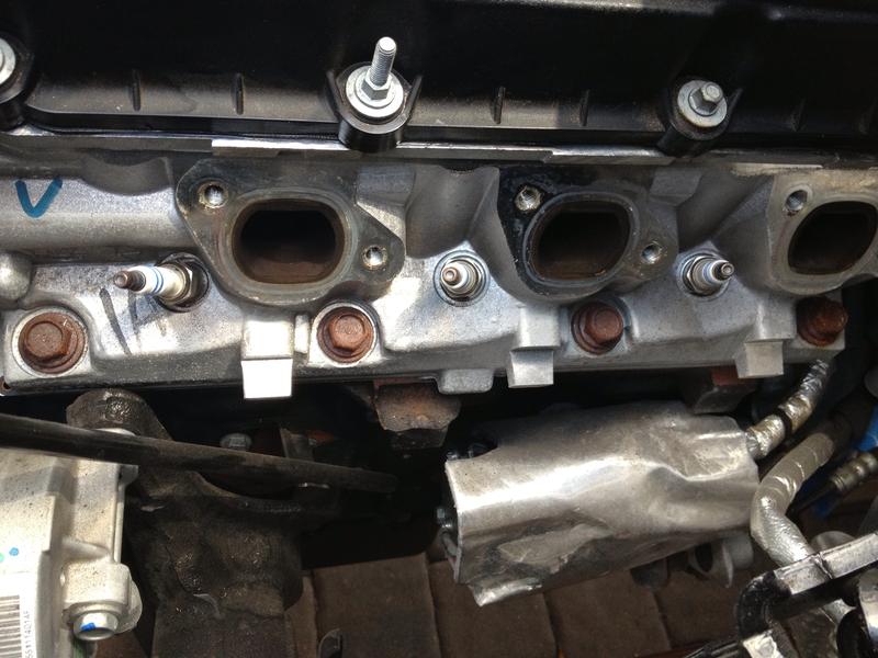

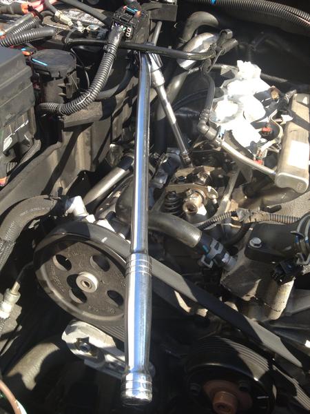

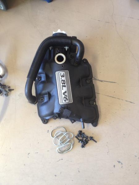

The coil PAC will need to come off to get the intake manifold & right valve cover off, but it's no biggie. I found that you'll need a breaker bar to remove factory head studs cuz they are torqued down really good. Also, I added Velcro to the bottom of the boostsapump in order to keep it in place between the battery and the fuse box. I also used a hex wrench to had tighten the ARP head studs into the block.

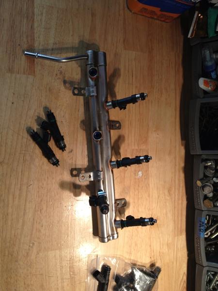

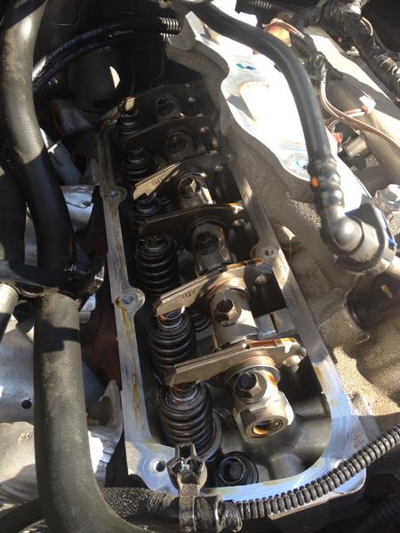

Old Mar 30, 2013 | 04:35 PM
  #47
Joined: Oct 2012
Posts: 109

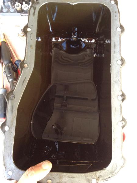

From: Lithia, FL
Default More progress

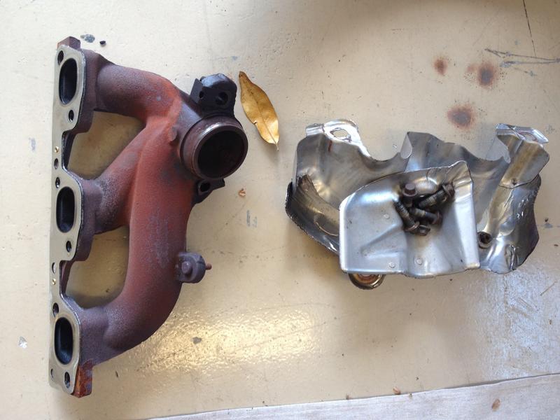

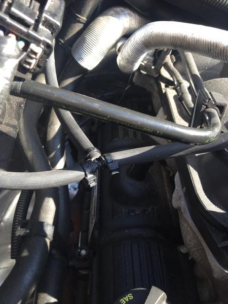

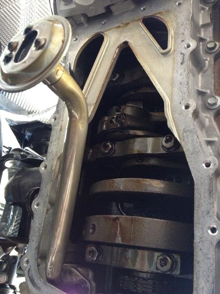

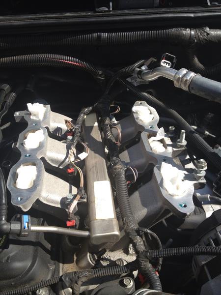

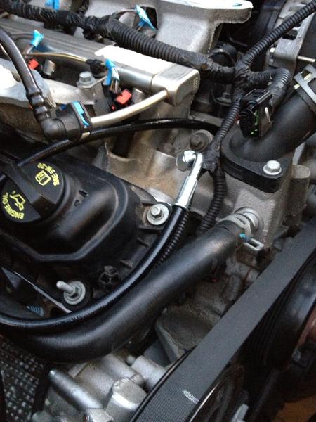

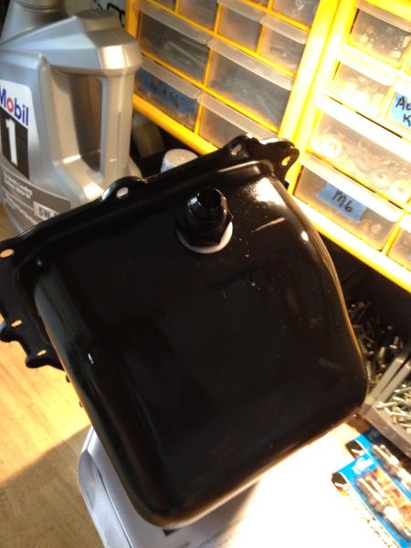

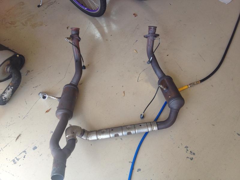

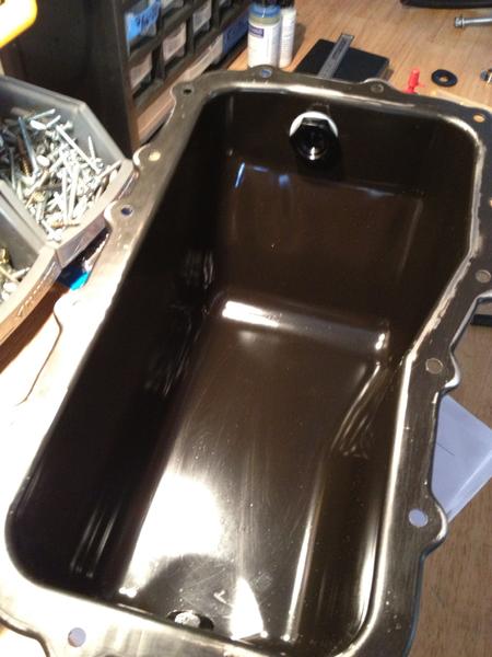

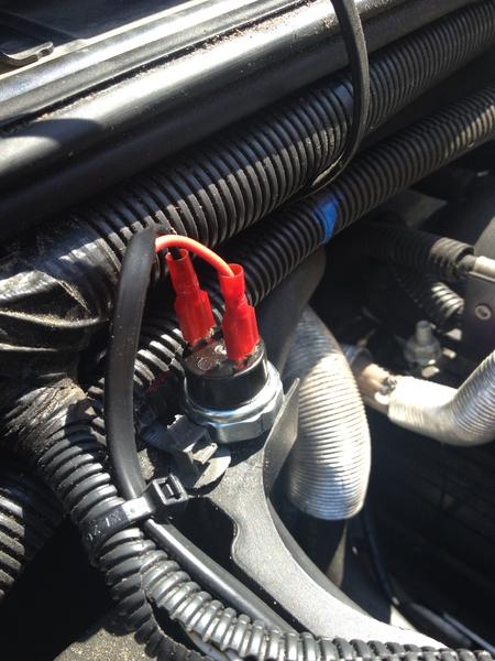

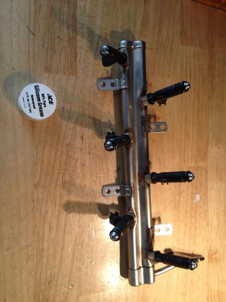

Today I finished up the ARP head studs and riped the old exhaust off. Also, installed the new bigger flowing fuel injectors and the turbo oil return fitting in the oil pan and the turbo feed line
ID:	440485   Click image for larger version
ID:	440486   Click image for larger version
ID:	440487   Click image for larger version

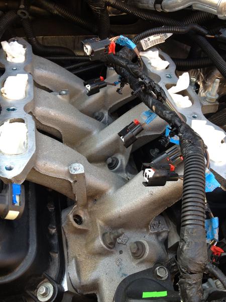

Old Mar 30, 2013 | 04:39 PM
  #48
Joined: Oct 2012
Posts: 109
From: Lithia, FL
Default Even more pics
Here ya goClick image for larger version
ID:	440489Click image for larger version
ID:	440490Click image for larger version
ID:	440492   Click image for larger version

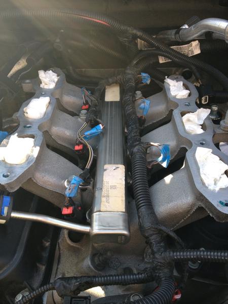

Old Mar 30, 2013 | 04:44 PM
  #49
Joined: Oct 2012
Posts: 109
From: Lithia, FL
Default And even more pics

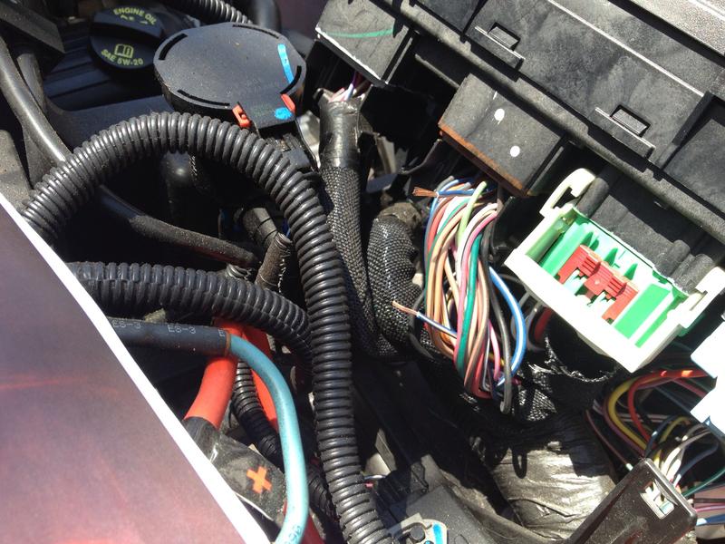

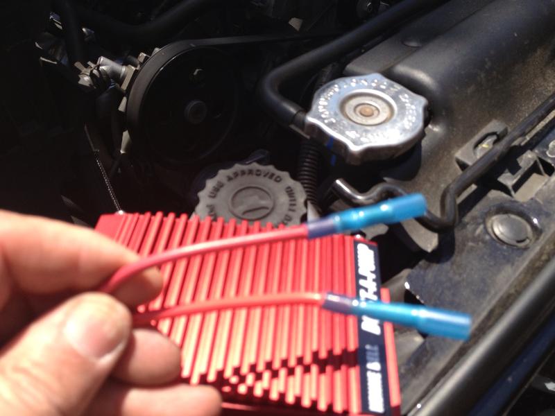

Tomorrow ill try to get the IC & Turbo mounted cuz I have the 12 psi tune and want to road test it
