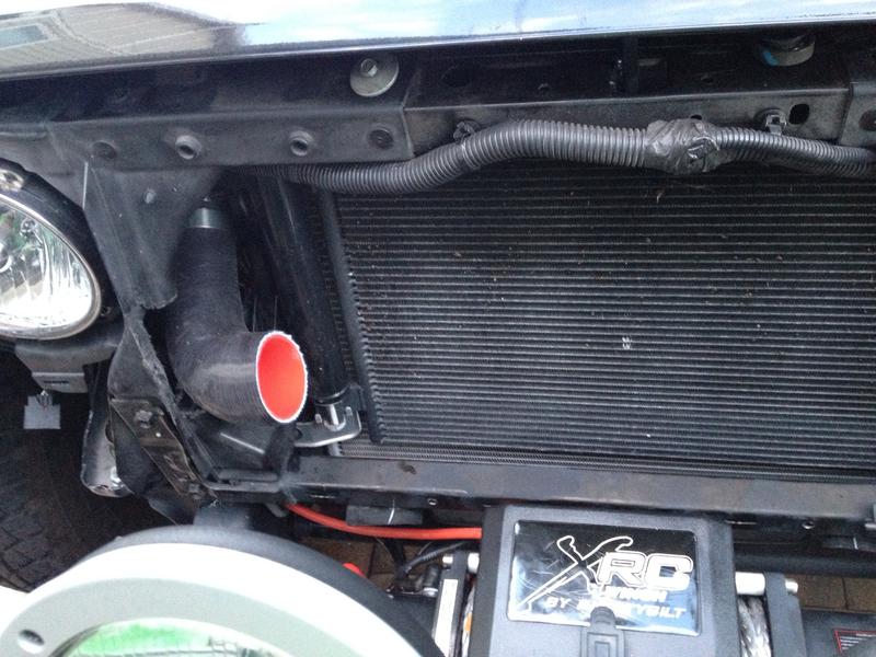

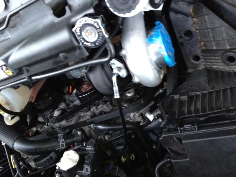

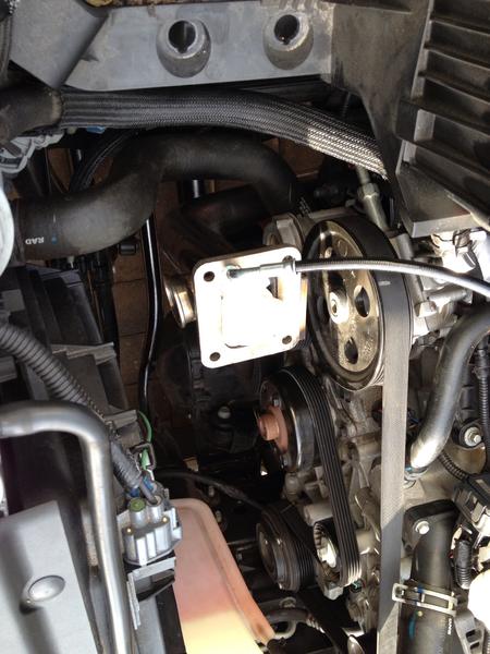

Default Easter Day progress
Not a lot of time today but just enough to get the exhaust installed so I could mount the turbo and started workin on mounting the intercooler. Tomorrow I should be able to wrap it up.
