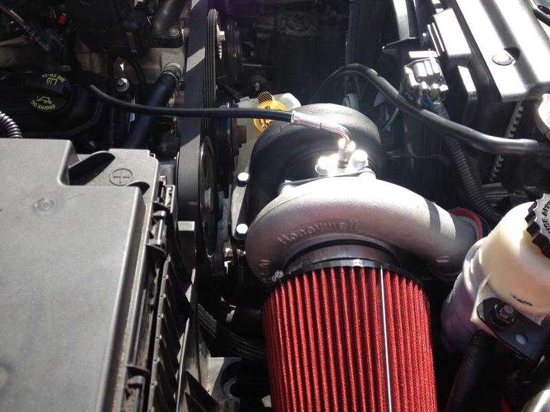

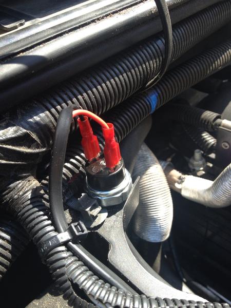

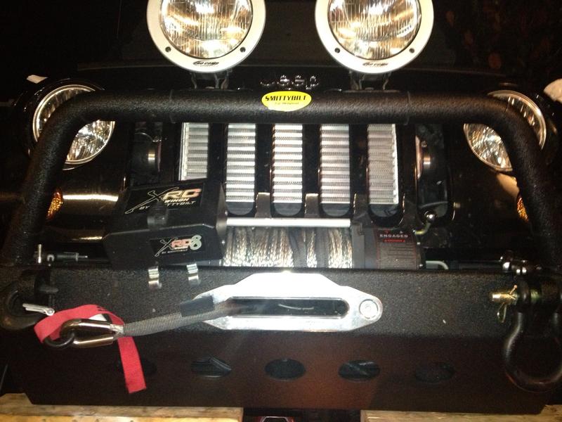

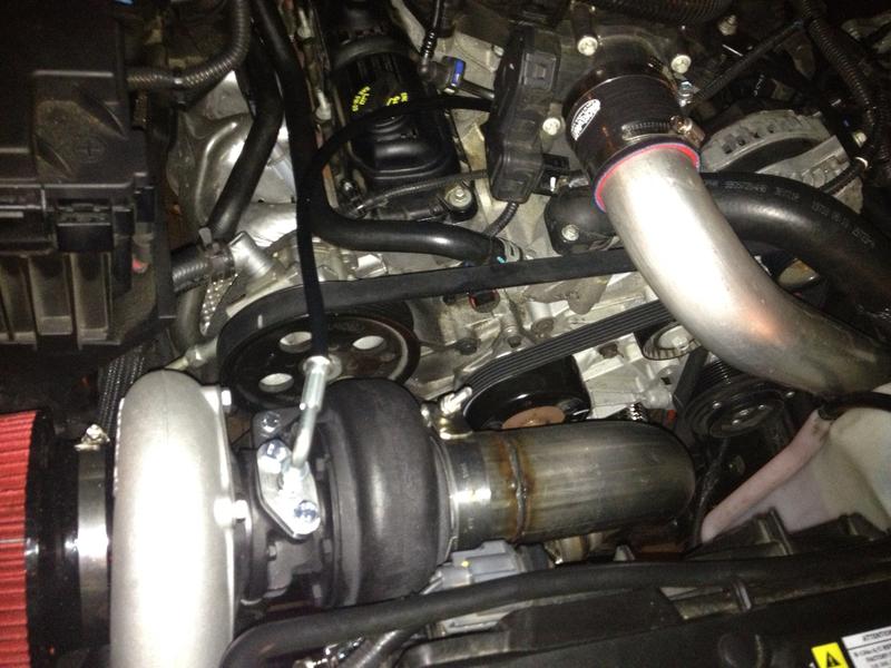

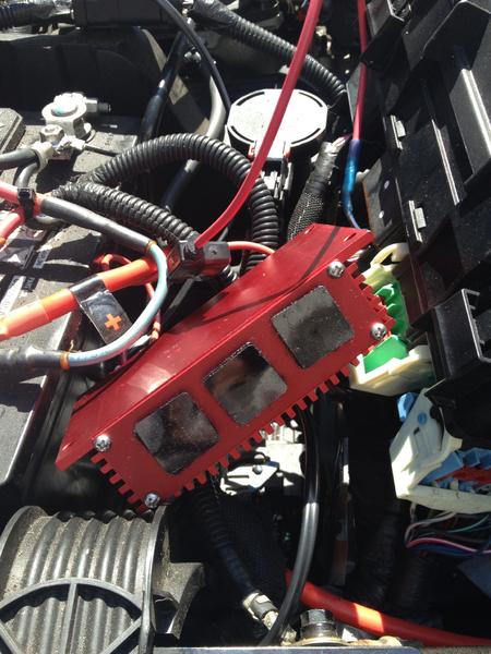

Default Install finished
I finished the install late so I'll load the new tune/calibration in the morning and do some road testing. Everything went on w/o any major issues except the high flow muffler. It wouldn't fit no matter what I did to it so ill have a muffler shop put my Jeep on a lift so they can modify the muffler so it will fit.
