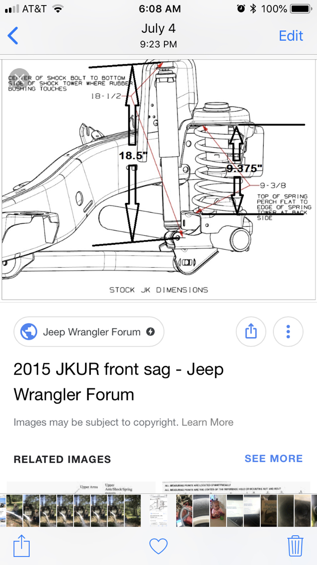

For liftmeasurements, these are what you are looking for. The rear is less important than the front.
How heavy your Jeep is will determine lift height. My 2door is about 800lbs. Over stock without fuel or passengers. My old Teraflex lift was only giving me about 1.25in of lift in the front, and was actually about stock height in the rear maybe a little less. My new RK 3.5 2 door springs put me a bit taller than 2.5 (maybe more like 3). If you keep your stock fenders without cutting them you will have trouble if you want to go 35s. Wider tires will require new wheels or wheel spacers. At 2in and 33 I don't think you'll need much else. Move the rear sway bar links to the front, and get longer rears. Remove the front lower brake line brackets to allow more length. Get rear brake line drop brackets, or preferably new longer rear brake lines.

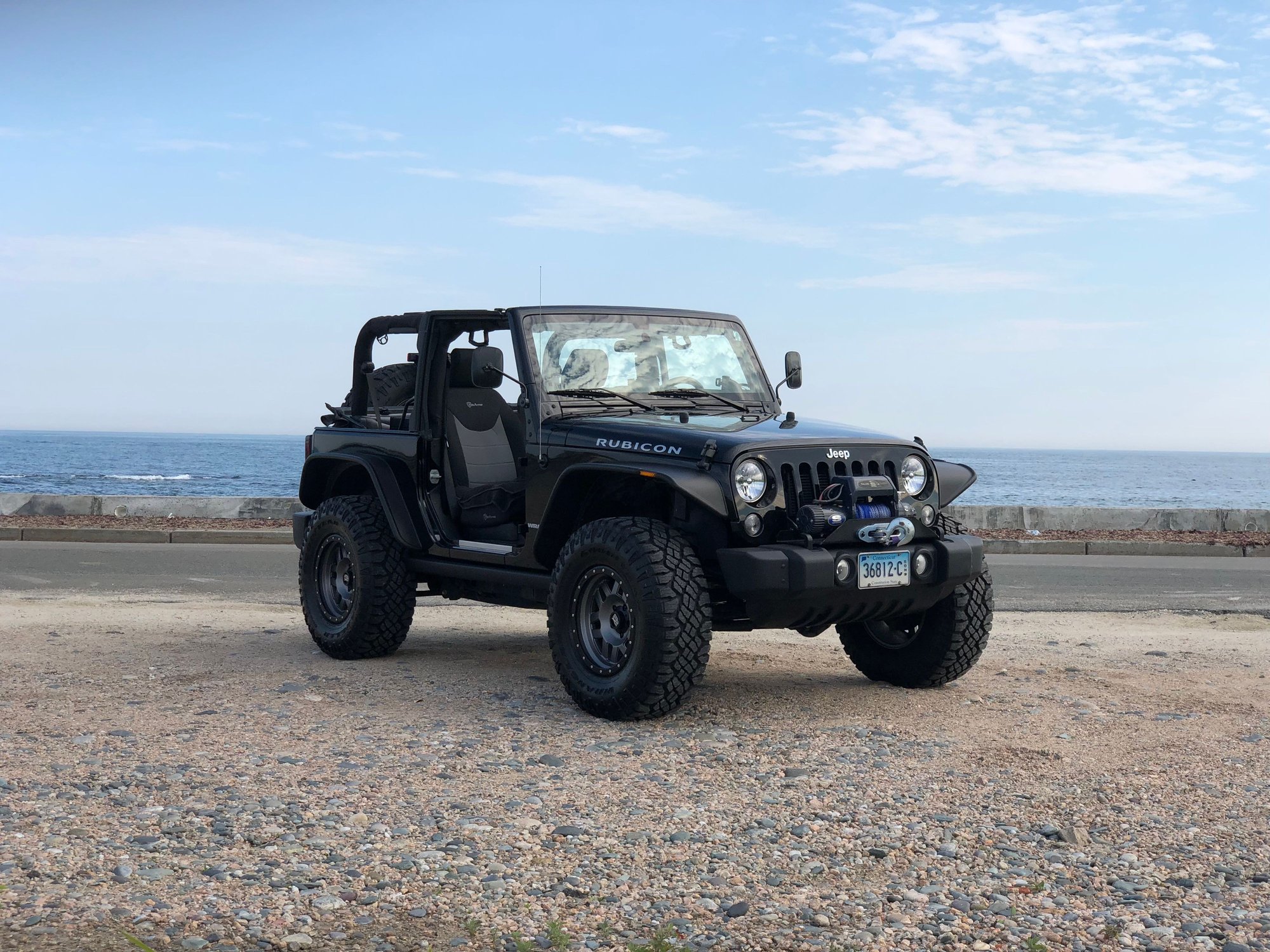

I have a 2015 two door Rubicon. I run a 2" AEV spacer lift and love it. With this lift, stock flares, and stock wheels I was able to run 285/70 R17 tires. I put two washers on each steering stop and never had any rubbing even when articulating. I was never disconnect or did any extreme articulating so I can't speak to that but no rubbing otherwise. I recently went to 35's. This required flat flares, new wheels with 4.5 BS, rock rail trim, air dam trim and a bumper chop for good measure. I'm really happy with my Jeep. Great ride, no rubbing, less lift means less stress on components. Just thought I'd share my experience.
