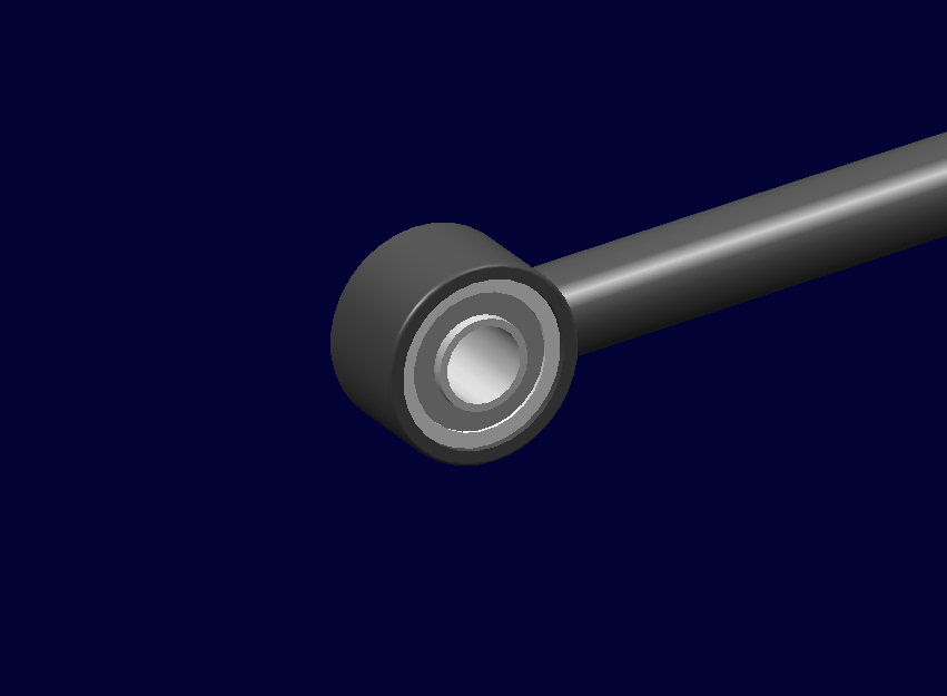

The first picture shows a CAD model of the stock end with a "thick" bushing wall thickness:

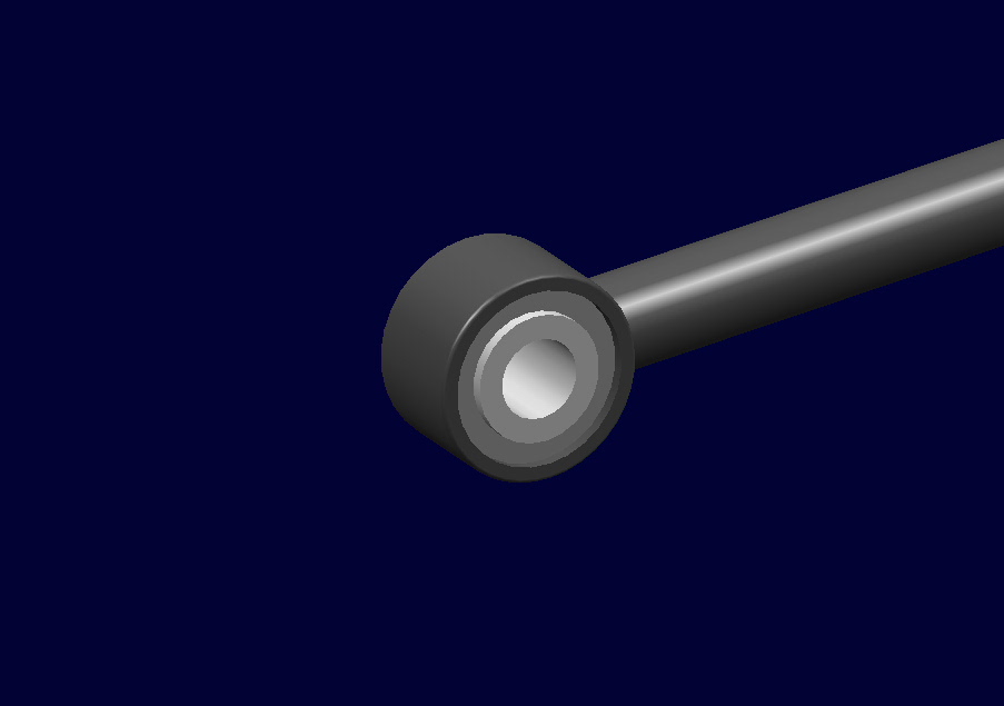

This picture shows a CAD model of the Teraflex "thin" bushing wall thickness:

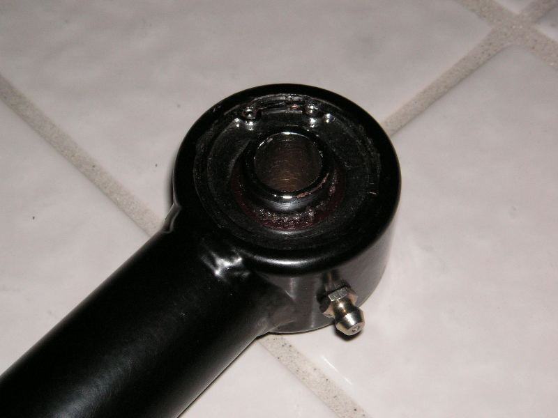

This is the actual Teraflex Track bar showing the "thin" wall bushing:

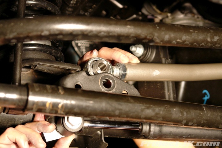

This shows 'Wayoflifes' Full Traction Bar which has a "WIDE" wall bushing to distribute the pinch load more evenly across the differential bracket"
