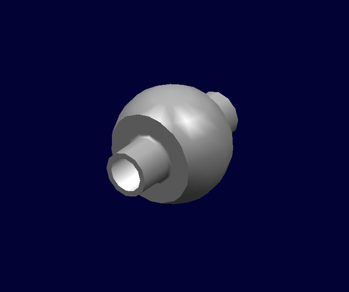

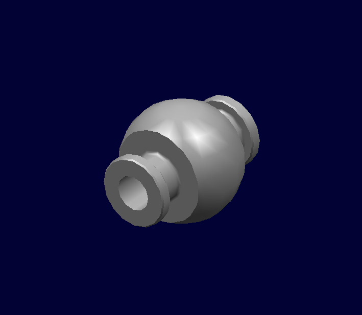

I understand the internal joints are dfferent all to well. A normal Heim Joint that is found on both the FT and Superlift bar has a metalic spherical ball within a metalic casing, where as the TF joint has a metalic spherical ball within a polyurethane casing.
I agree that FT and Superlift use the 'bushing' you're refering to as a spacer to get the correct width on the heim to the axle bracket, but they also machined the large OD into that 'bushing' to distribute the load onto the axle bracket. The bushing on the TF spherical ball is actually machined into the ball, but that bushing has too small of an OD.
It should be machined something like this:

no offense, but i dont think you are qualified to give any kind of opinion as to how something should be machined,
if you think that it should be done differently then do it yourself,
there are plenty of pictures and diagrams online showing each trackbar and each joint, so you should have been aware of what you were buying before ordering.

I can understand what is the conceived problem here, but someone correct me if I'm wrong. If everything is tightend the way that it should be, then the track bar is going to rotate in the joint, not between the bracket, therefore, the bracket would not be wearing, correct? I do underrstand if the mating surface was thicker, there would be less of a chance of any wear taking place (more mating surface to distribute the load), however if there is wear there on the bracket surface, it truly sounds to me like that track bar bolt was not torqued to the correct specs as it should have been.

After reading this post I decided to send a quick note to Rand at Teraflex, who I met at the Drummond Island Jeep Jamboree. I had a few other questions for him, but also forwarded him a link to this thread. I don't know why they haven't gotten back to huskynox, but here was his reply to me:
"I saw the post on the JK Forum and showed my head of engineering. He will make an adjustment to the center sleeve to increase the contact area. We haven’t had any issues during 16,000 miles of long term testing between our 2 JK’s but the fact that one of our customers had an issue tells me we need to address it. I cannot say how soon the change will occur since it will be an in-line change to the product when we run out of current stock. If the bolt is kept tight there should never be any movement in that area. I am not disputing what the web forum post says, I have seen his photos and his CAD drawing suggestion. We always welcome feedback from our customers. It is part of what helped TeraFlex become the company it is today. We cannot possible think of everything, but our customers seem to always have something to offer in the way of product improvement suggestions."
