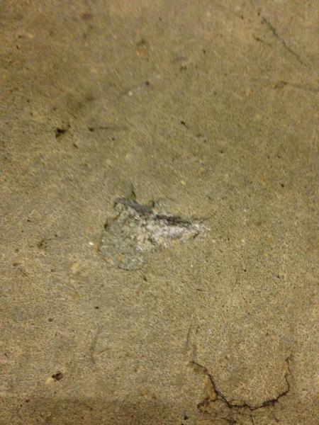

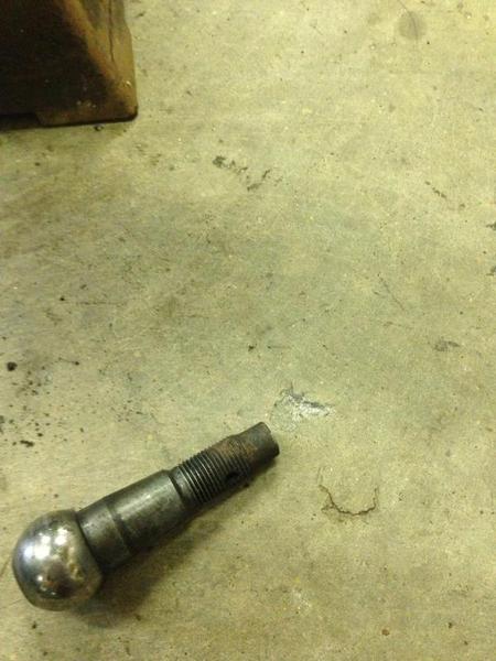

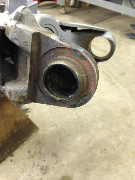

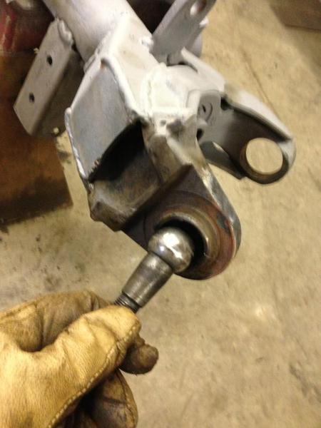

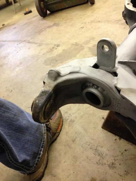

I was about 6 beers into my axle rebuild last night and was having trouble removing one of the bottom ball joints. After trying a 6ft breaker bar on my ball joint remover and a 20 ton shop press i decided to break out the ole torch. I heated the knuckle for about 2 mins then all of a sudden...BOOOOOOMMMM!!! I'm not talking a pop I mean like a freakin gun shot right in my face. It blew out my torch and knocked me off of my shop chair. I was kinda disoriented and my ears were ringing...i was like wtf just happened. After realizing I was okay I checked out the damage. Apparently the ball joint was sealed so well that the grease boiling or something built up pressure inside and shot the threaded ball out like a bullet. Luckily it was pointing towards the ground....if it had been facing me it proly would've killed me...it shot out like a bullet. It knocked a chunk outta the concrete under neath it. Luckily i wasn't hurt and there wasn't any damage to the axle. Good part was the rest of the bj came right out hahah.
Just a word of caution to those who like to use tha torch like me when things are being stubborn.
