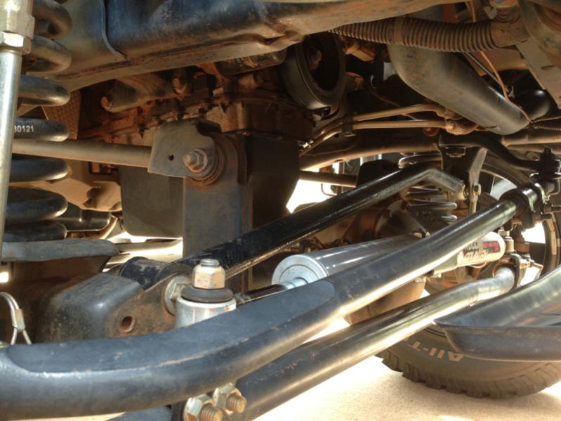

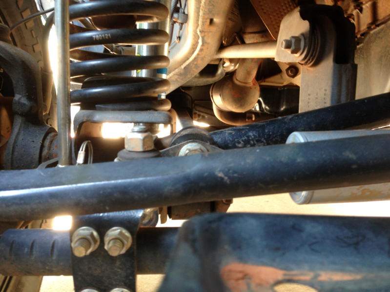

Here's a pic of my steering geometry, does look like the track bar is lower than the drag-link.

With bent bars, it is hard to tell from that angle. You might try a frontal shot that shows all 4 mounting holes. And then just draw straight lines to connect the holes. Since you removed both the bracket and the drop pitman, they should be roughly parallel and not contributing to the steering issue.

It's hard to get a front shot without having to take off the front splash guard and its a pain.
The track bar (axle side) appears 1-2" lower than the track bar.
