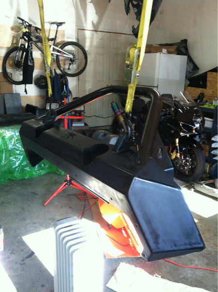

I'm painting mine this weekend too. And yes, I wet sanded with 600. Mostly it was to fix a fingernail scratch I left in it from touching it before it was dry. But the wet sanding will help with the finish.
Pic is after wet sanding before final coat.
