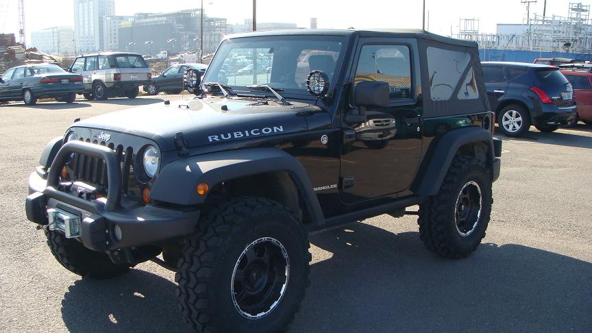

Hello Guys,
I just put Super Swamper SSR 35" Tire on my JK Rubicon. I have the 2.5" Teraflex budget boost. I have had those tire on my TJ before and run then for more the a year and a half all year long in Montreal. Those tire are very amazing. They do very well off road, on the rock or in the mud. In winter in the snow the work very good to. You do have to be a little careful about them do they can get little slippery. The tread is very aggressive and bite to snow a lot so be careful it will dig hole and pull you away if you don't go easy on the gas. They have a soft gum and stick very well to ice to. They are radial and do very well on the road they are not that noisy. I just did a 1000km this week-end and I was very impress how quiet they were. As the JK it is more sound prof than the TJ.
As for the Teraflex BB you will be amaze what you can do with this and set of 35. They is a little rubbing at the back on the body or rock rail in the case of rubicon. I will suggest that you trim the body right in front of the rear wheel right under the fender. This will make place for the tire to move up and use all the travel you can have. I will trim mine soon I will take picture and post it on the forum.
We will also like to ride for your day to day use.
I just went to the Winter fun fest neer lake tahoe and I was able to follow all the big rig, TJ, YJ or XJ with 6" lift and 35".
Sorry for the long post but I hope this will answer all your question.
Here is a Picture of my JK
JM
