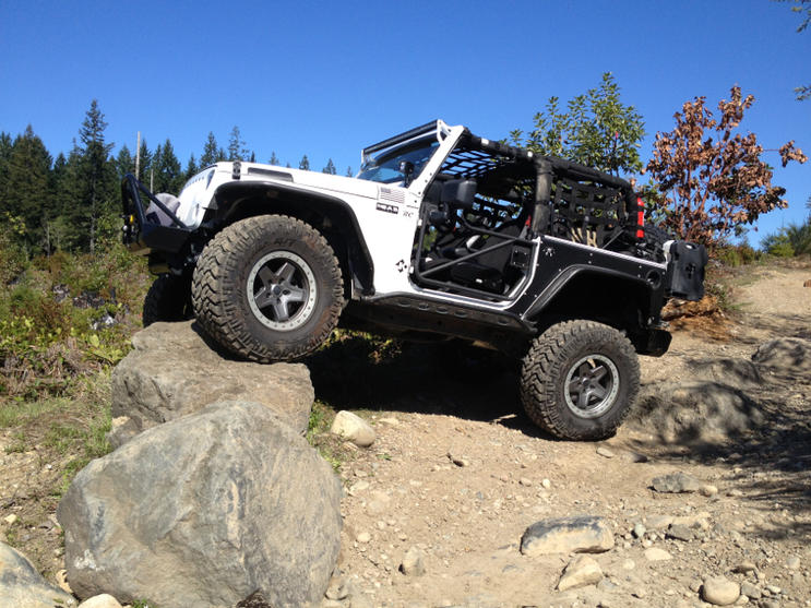

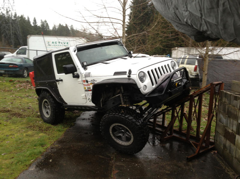

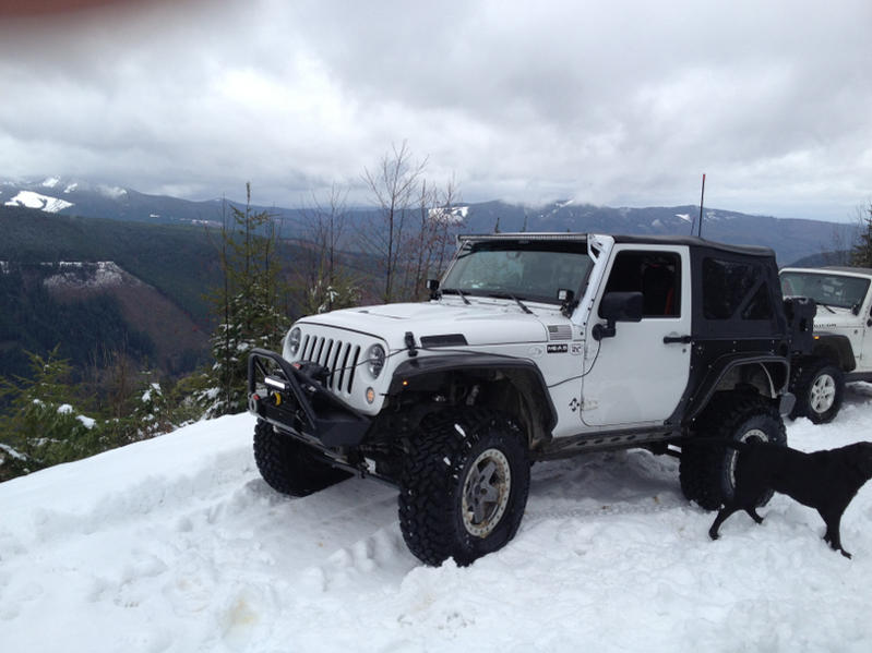

I'm running a Tera Flex 3" lift on 35's.
