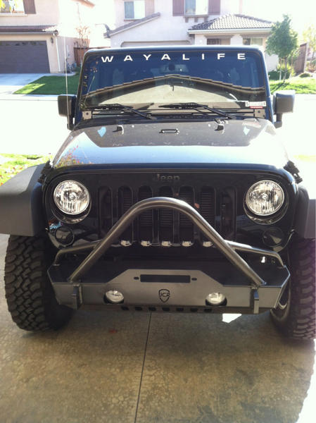

Rustoleum hammered black is what I painted my JCR stubby with.
