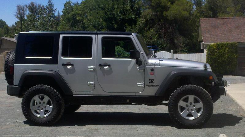

I have 285/7517 toyo mt and love the look. I have the teraflex 2.5 coil lift and added a 1" spacer all around because of winch and bumper with 1.5 Spidertrax wheel spacers

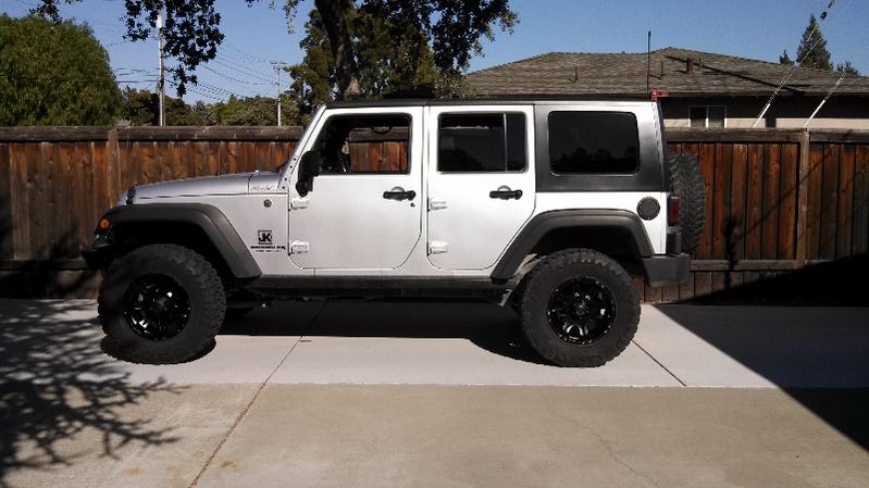

Just last Saturday i got new rims. I now have 75,000 miles on the tires
