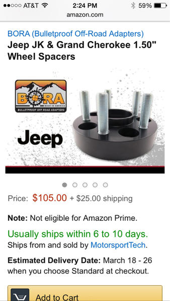

Originally Posted by Invest2m4
Check out Bullet Proof Offroad. About the best adapters I've seen. Hub centric and lug centric. Popular among the guys running diesel trucks and towing heavy loads.
I'm thinking about going back to stock wheels with 37 bfg's, is this the one you're talking about?
