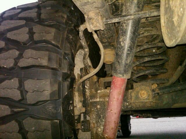

So, based on the info you guys are giving, I'm guessing I'm calling this part the wrong thing. Here are a couple of photos...
So whats rubbing can't be turned to the inside. What is this?
Thank you for all the help and info though. I do appreciate it guys.

That is the swaybar.
And this is the reason it is rubbing
Re-centering the axle will fix it.
Or, maybe you can pull the whole swaybar over a bit? (And then push it back to where it is now when you get the trackbar bracket...)
But my big two "wtf"s at that the axle now sits something like an 1" or so to the passenger of the Jeep.

It's not clear to me, but it appears that OP is running 2.5" BB with 35" tires on stock wheels. The issues he's complaining about are due a combination of the axle shift with the large backspacing on the stock wheels. Replacing the wheels with better BS (about 4.5" is good) will solve the sway bar rubbing the tires by putting the tires out farther. The other option for this is wheel spacers (such as these). Fixing the shifted axle can be ignored, but if OP wants to will take a relocation bracket, or an adjustable trackbar.
