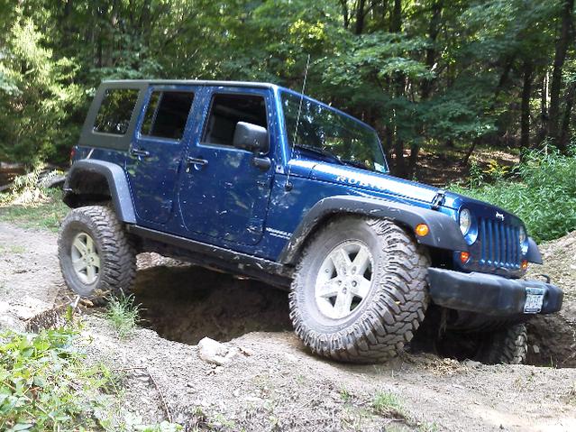

4" lift, 37's, 2" bumpstops, full stuff. Wanted to keep full fenders so just trimmed inside of fenders. Very easy to do just trial and error. Pinch seems need to he cut or bent over, your choice again very easy to do. Stock front bumper can be kept as well with a little trimming. Pick is disconnected full stuff, very minimal contact with a cooper 37 mud terrain.

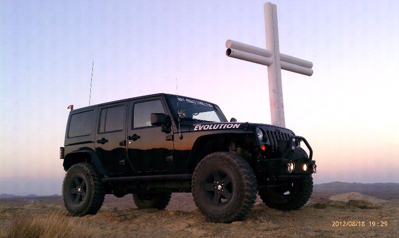

I'm running the 2.5" teraflex coil lift with a 1 1/4 body lift on 37" km2's on stock wheels with spacers. No rub anywhere when fully flexed.

Well it's a 2012 Rubicon so I have a Dana 44 in the front with EVO sleeves and gussets that I installed myself and stock rear d44. I haven't really had the chance to wheel it hard. Just some mild crawling so far. I have been spending most of my time and money modding it like the suspension, body lift, j.e. reel front driveshaft. armored the sway bar motor,engine and trans, evap. Canister. It's only got 9k miles on it so far. Gonna upgrade axle shafts and get some evo body armor too
