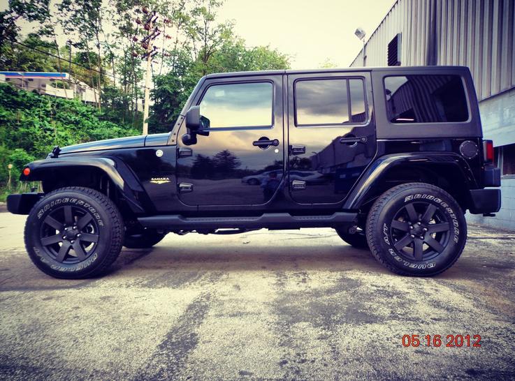

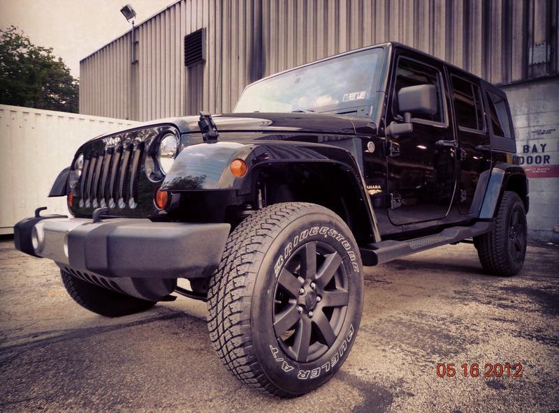

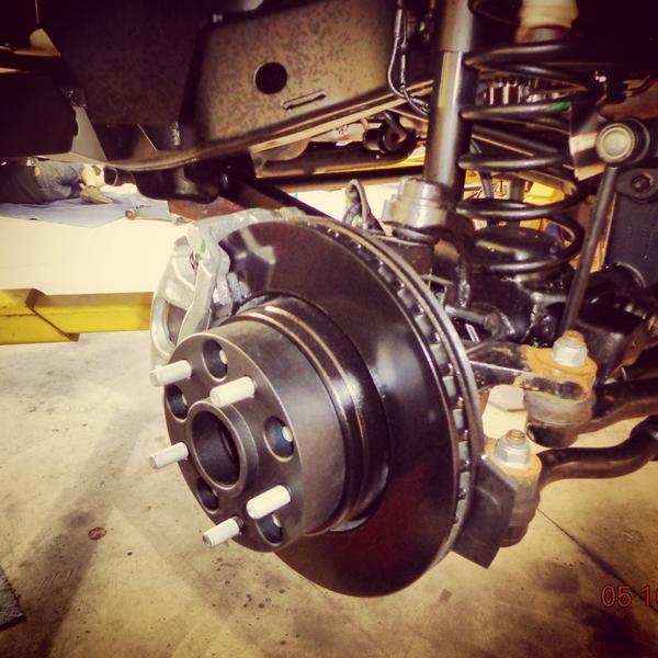

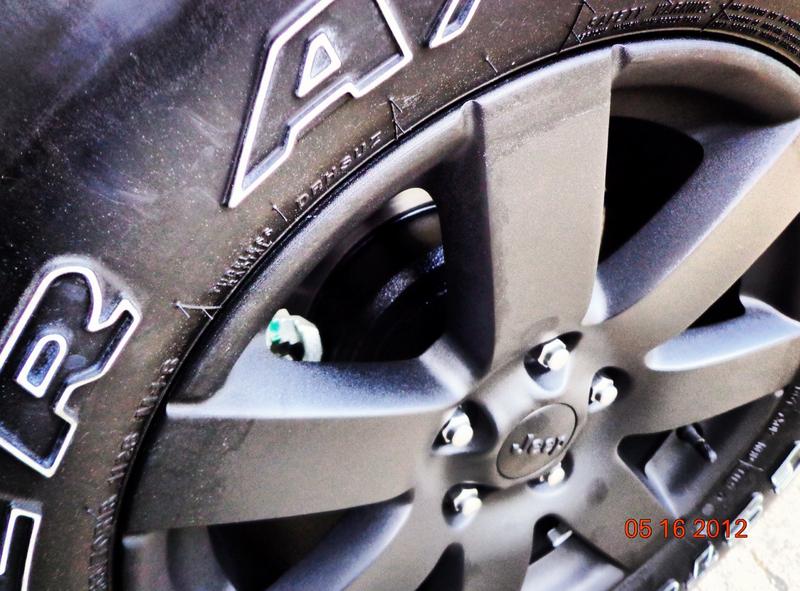

Here are a few shots of my Jeep with the Teraflex JK 1.5" leveling kit and Spidertrax 1.5" wheel spacers. I kept the stock wheels and had them powder coated. It pushes the wheels out perfectly so the edge of the tread is still under the fender and legal here in PA.

It is a little different than running wheels with the correct backspacing. You have to locktite the nuts on the spacer and still go back to re-check / re-torque every so often. I found out the hard way on an old Ford XL390 when we used spacers to adapt to a set of wheels rather than changing to the correct spacing. Coming to a stop sign at about 15 MPH the right rear tore through the quarter panel and passed me by. Pretty bad day. Loved the car, but being a teenager, with all the other problems (rust, someone had changed the tranny out for an FMX, the top was shredded and the interior had suffered too many unintentional baths) before I bought it as a first stab with a project car. I haven't been able to look at spacers the same since. Just my $0.02.

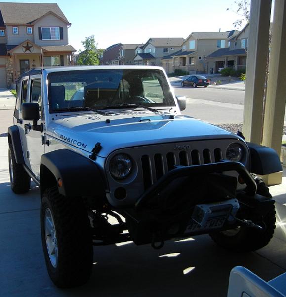

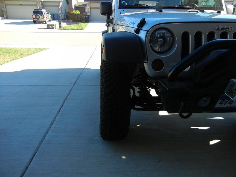

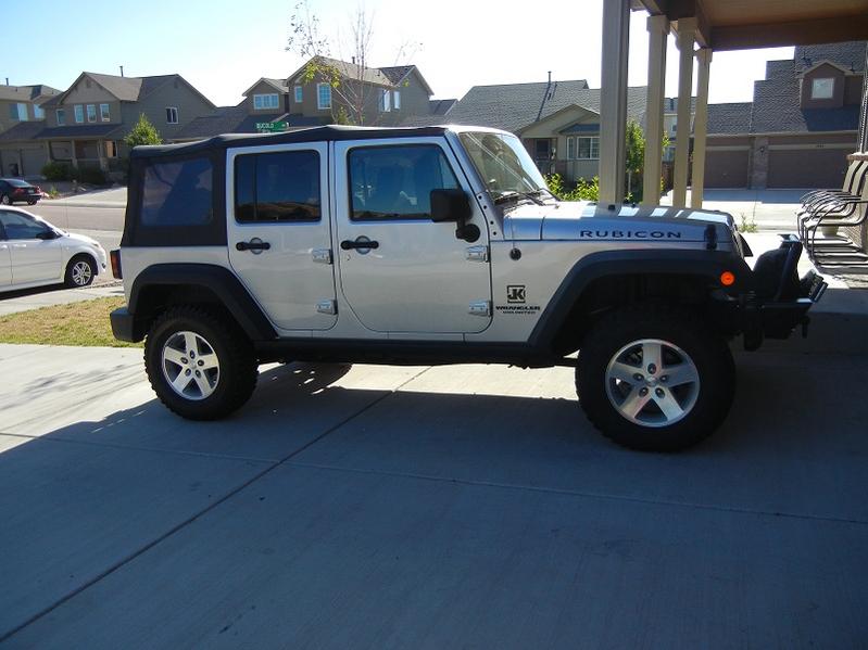

Well the drive is at an angle, but it sits level on flat land. And rides like stock. This should hold me while I burn these tires up.
I now have the confidence that I can do a lift myself when the time comes.

This looks awesome and is exactly what I've been thinking of doing to my Silver Rubi....... a couple of questions though.
What spacers did you use for the wheels?
Also, do you have pics from the front or back that show how far the wheels were moved out from stock?
