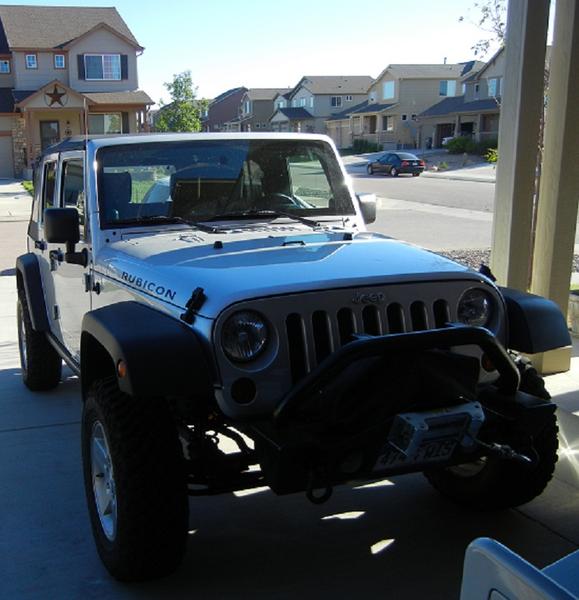

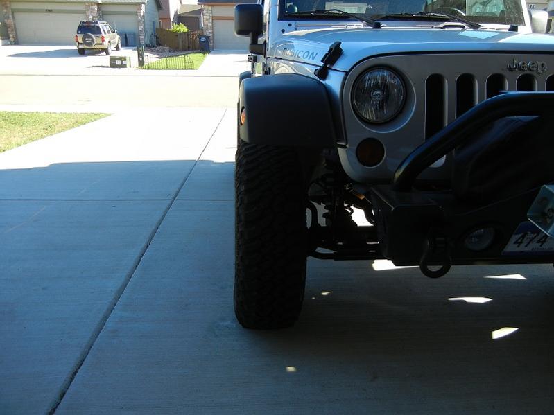

From: Colorado Springs, CO
Originally Posted by ddhowel
This looks awesome and is exactly what I've been thinking of doing to my Silver Rubi....... a couple of questions though.
What spacers did you use for the wheels?
Also, do you have pics from the front or back that show how far the wheels were moved out from stock?
Thanks,
Dwight
Hi Dwight.
I can get a pic later today. The wheel spacers I used were some RC brands I got off a Colorado Forum member here. Not as good as the Spydertrax, but will serve my purpose until I can get some new wheels.
I can tell you the wheels are now flush with the outside of the factory flares.

demtek9's Avatar
Posts: 748
Thanks, I'd really appreciate it
Hope this helps you out.
