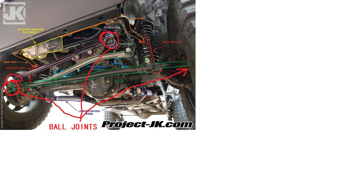

Originally Posted by toad
Would you happen to have a pic of what a ball joint might look like and where it's at so those of us that don't know can get a visual?
gladly...
the flexible parts on the ends of the drag link and tie rod is the ball joint (where they connect to the axle/ axle C) unfortunately our JKs ball joints are un-serviceable which means the entire component needs to be replaced when the ball joint finally dies, or atleast untill one our our many genious vendors whips up and aftermarket one with serviceable joints.

also the swaybar links (non rubi) have ball joints in them as well but these are not under the same stresses the above 2 componants are, thus they last alot longer

i thought that the ball joints were at the top and bottom of the knuckles and the other parts are just called tie rod ends
