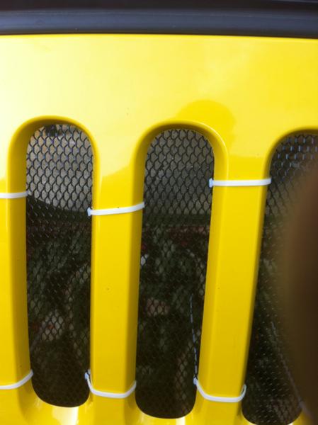

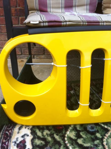

I just used gorilla glue and the metal gutter guards painted black. It's held
Going on 6 months no problems. Used
Zipties toHold in place while glue dried. Make sure you wet the surface a little if you use the gorilla glue so it foams up.
