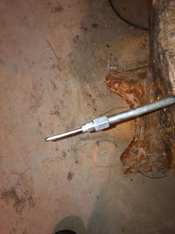

@Sixty4x4 I've tried every needle fitting I have access to get that one DC flat faced zerk. It never wants to go in and makes a mess. I just pull the shaft from the transfer case and have an assistant pump the gun while I hold my needle fitting against it. Can you please show me what needle fitting you use to get the DC? Possibly a link to where I can buy the one you are using?
I have never had an issue getting to my DC zerk with a basic Lincoln needle fitting....even with skids in place. It's tight but doable. Having front hub conversion makes it a little easier for me since i can freely spin the DS. Sixty is on MC 2.5" lift as well, like you with your 2dr, so I would think you should be able to get at it if the DS was in the right orientation.

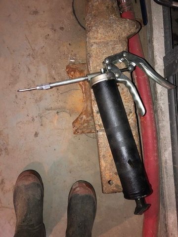

Seizer - this i what I use to grease zerks with. Bit awkward on a creeper but manage to hold it against the little ball stop in the zerk and pump at same time.
That is one of the styles I have. I’ll try it again next time, but it’s like the flat zerk ball resists any pressure unless on it perfectly squared up.

that is what i use too, but on a flexible line. i typically go in with the head at a slight angle and slide the ball out of the way......but that's just how she likes it.
