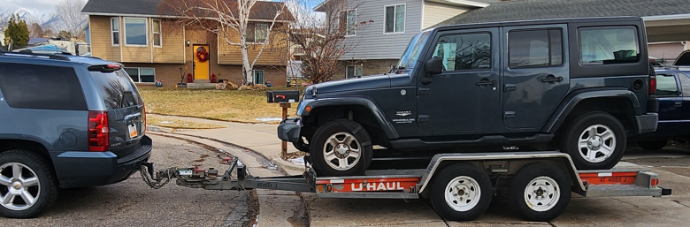

I recently picked up a 07 JKU with a severe rod nock as a new project vehicle.
The price was just too good to pass up.
This is my first Jeep, and I'm currently in the process of figuring out how bad the damage to the engine is and what to do next.
The subject, being towed by my last project vehicle.

Welcome to JKF.. the 07 looks good, there are many utube videos on LS swaps into JK-JKUs. We have members here that have LS swapped successfully

Welcome to JKF. Thanks for taking the time to introduce yourself. From that one side shot, that jeep body looks to be in good condition.....and about to get a new lease on life. Few folks here have done V8 swaps. @Sixty4x4 might have some good commentary for you on that front.
