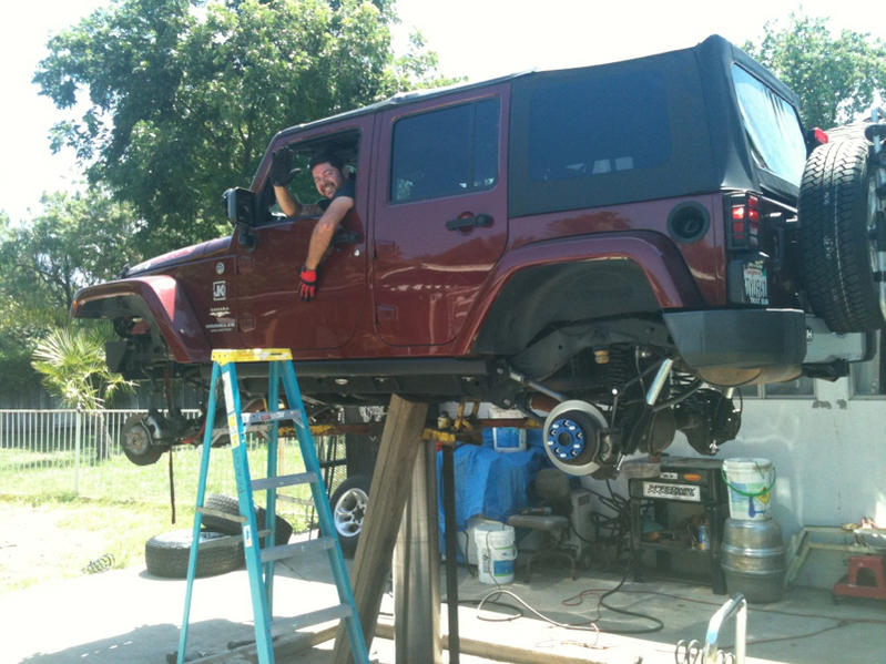

Yeah I will. One thing at a time. Luckily I'm going out of town this weekend and can do all this work at my bro-in-laws house. He has a pneumatic lift... next to his garage
Attachment 439748
One day when I can convince the wife out of suburbia I will own a manly lift like that. For now its a small 2 car garage and cardboard creepers.
Every offroader could use a lift like that. If it makes u feel better, I don't even have a garage right now... just an uneven crappy driveway. I make do fine tho as we all do
