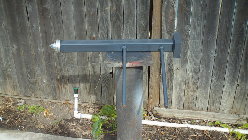

Getting ready to pound in my sleeves in a couple weeks! Anyone have a homemade sleeve driving tool that worked great for them that I may barrow or rent? I'm happy to pick it up and drop it back off at your location, just tell me where. Thanks!
ID:	594445You mean something like this
Old Jan 30, 2015 | 07:37 AM
Ajkaz's Avatar
Joined: Apr 2014
Posts: 505
From: Anaheim, ca
Originally Posted by familytime
Attachment 594445You mean something like this
WoW! Wish you were a tad closer!
Is that 1.5" square tube? What did you use to fasten the retaining bolt to inside the tube?
Cut a plate to fit inside,drill a 1/2 hole and weld bolt head to plate.Fit plate/bolt to end of tube and weld in place.It's 2" tube 1/4 wall
