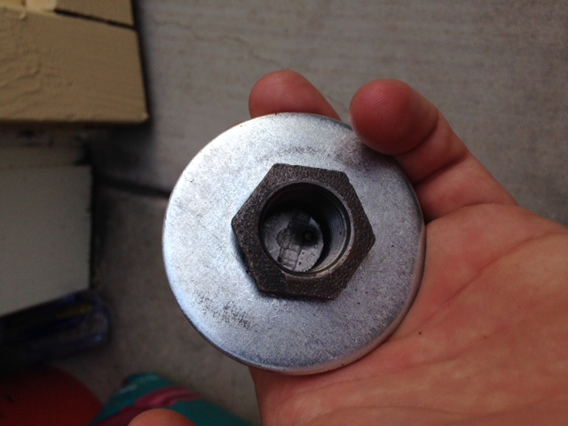

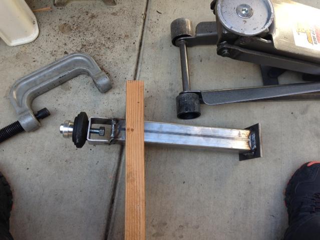

Decent weekend - I got the passenger side torn down, ball joints out, sleeve in and C's prepped for Gussets. Either FedEx Mis-delivered or someone stole my new Teraflex balljoints off my porch.... So reassembly will have to wait....
I made 2 tools. One for an air hammer out of some pipe fittings and large washers for under $5. The other out of 2" 0.25 square steel tube and part of a ball joint press along with a small bearing race driver. The air hammer got the sleeve to the knurl in under 5 seconds. four hits with the sledge and driver set the knurl.... I think I could have got the knurl in with the air hammer, but I still had the knuckle on and couldn't reach far enough through it. I did break the wheel speed sensor off inside the wheel bearing but was able to drill it and insert a screw into it to pull it out. No way it was coming out intact! You can see in the pic I stuck a nickel inside the driver to help stop the air hammer chisel from going through the whole thing, went clean through the nickel. I hope the drivers side goes as well as this did, after all it is an 07 JKR with 103k miles on it! Thanks for all the tips they really helped!
