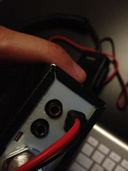

Originally Posted by Jeek.OlllllllO
Sorry I meant to say what type of wire is it. That connects to the CB. Its it a stereo mini to mini (3.5mm)

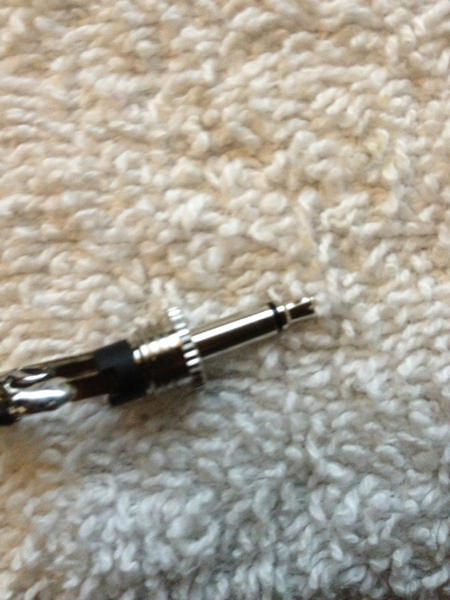

Yeah it's just an audio jack
Oh awesome thanks!

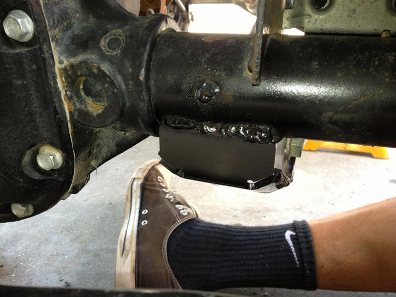

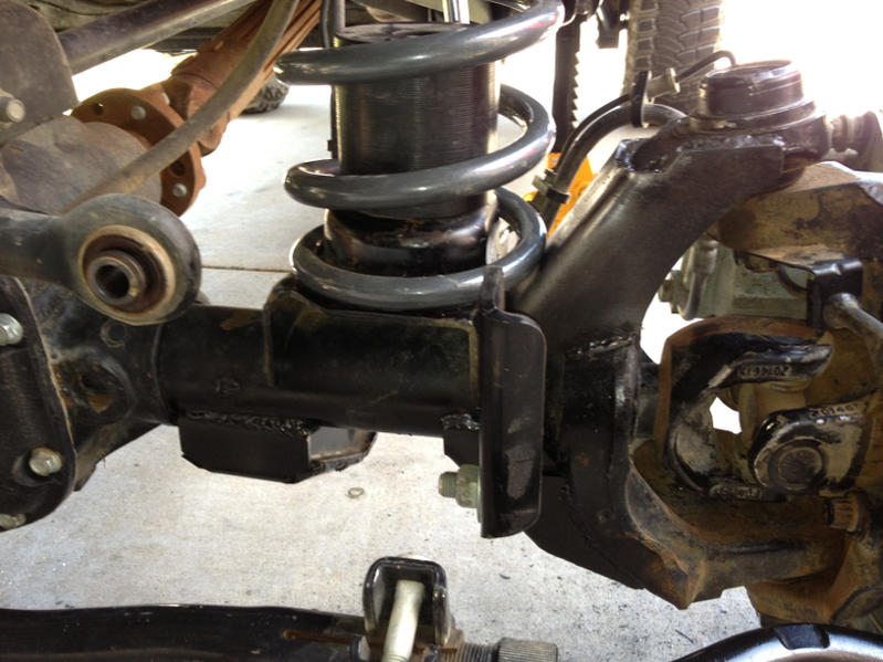

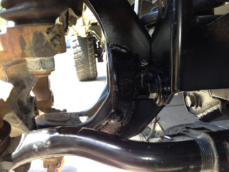

Sleeves, gussets, skids
Big thanks to Travis "BRUT4CE"

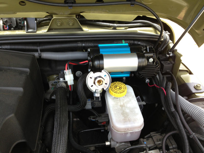

Mounted & wired ARB air compressor w/ EVO bracket.

If you're just going to use it for airing up tires, you can splice the red/black wires from the harness and connect direct to your sPod. You do not need to hook up the other wires (from the harness) to the pressure switch terminal, but you will still have to mount the pressure switch to the 3-way splitter (or cap it off).
EDIT: I kept the 40a in-line fuse on the (+) wire when wiring to the sPod, just to be safe.

No worries...
Time to hit the trail...btw that moab jeep is gorgeous......

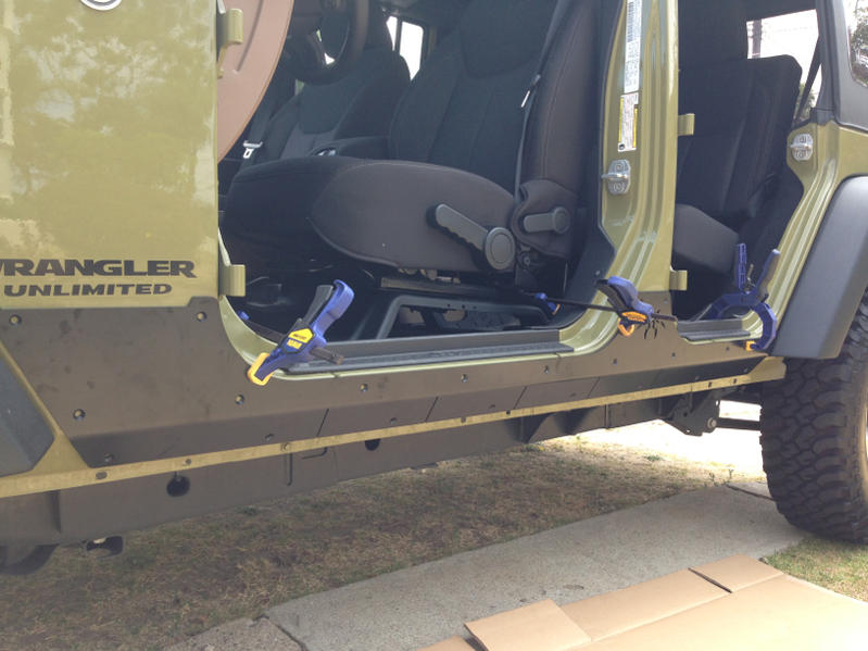

About to pull the trigger... no going back after drilling these holes!

What are you going to use for the nutserts?
