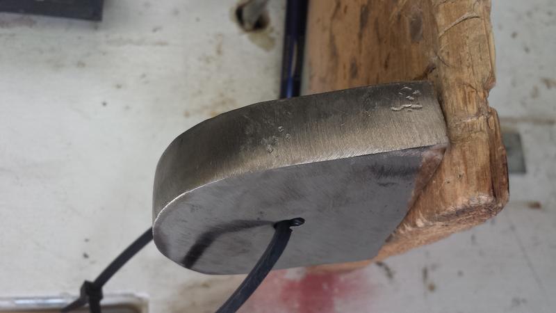

From: rosamond, ca
And I also cut the d-ring tabs at a 70 degree angle so when they are in place, they will have better ground clearance and departure angle hahahahahahaha

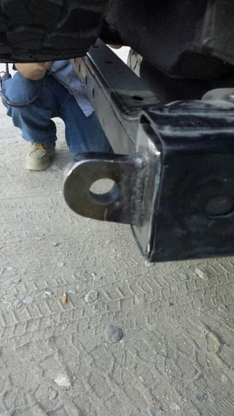

Originally Posted by bob-o
Plus I made the outside plates out of 1/4" steel compared to evo's 3/16 and I made them wider so they cover up the hole that the green arrow's pointing at
<img src="https://www.jk-forum.com/forums/attachment.php?attachmentid=490284"/>
Did you make them meet the end of the tube so they're actually bolt on? I noticed its a pita to get d rings on with out cutting the frame, which weakens the cross member for the hitch.
Yes sir, they slide right in flush with the frame rail, no cutting required

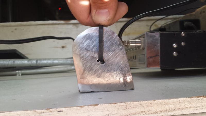

From: rosamond, ca
I didn't want to cut my frame at all so I made them fit flush without any modifications needed
