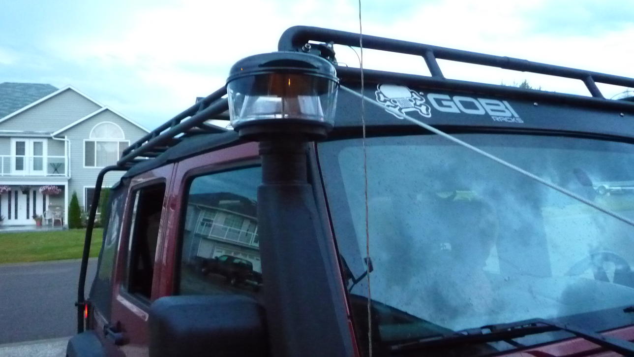

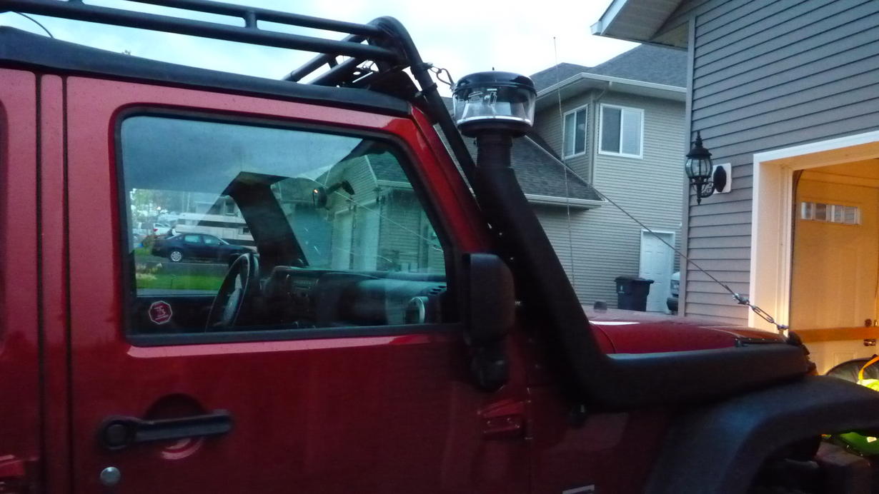

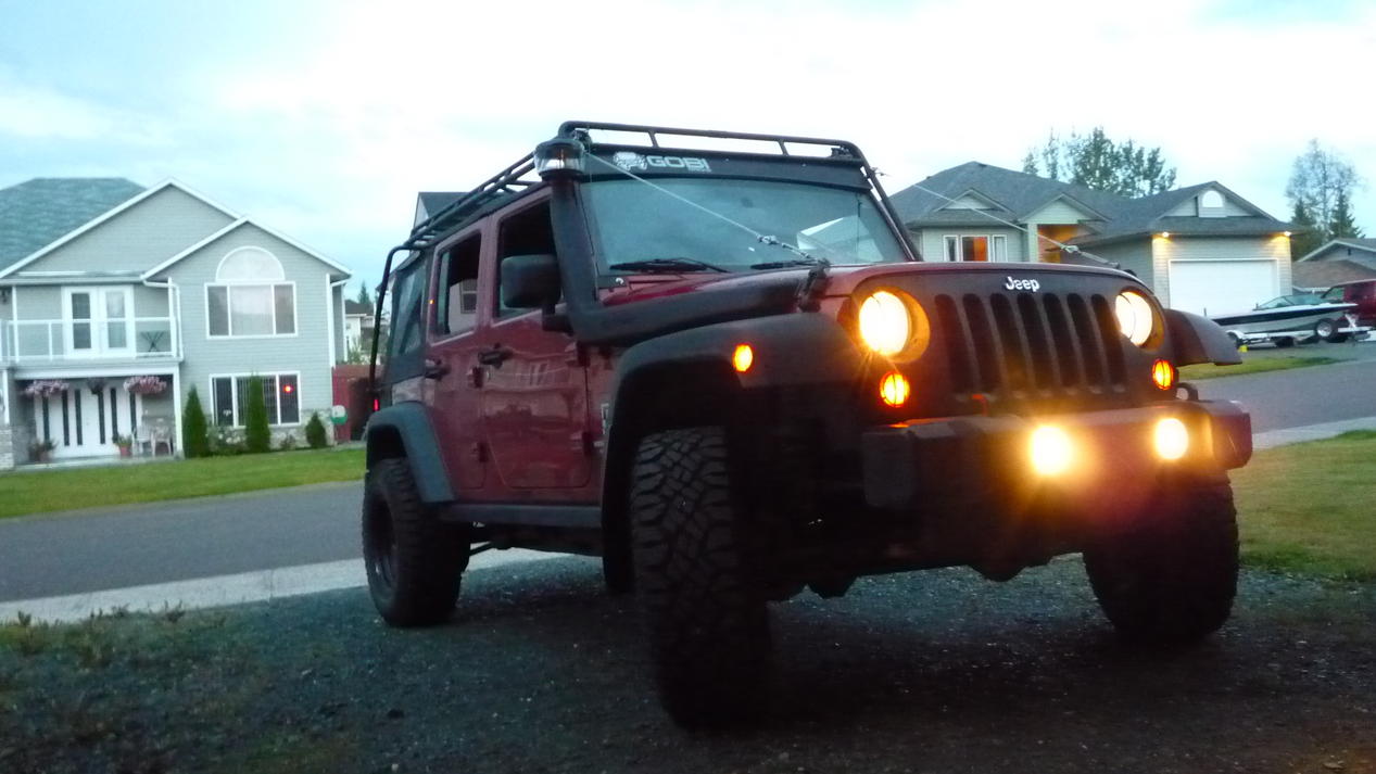

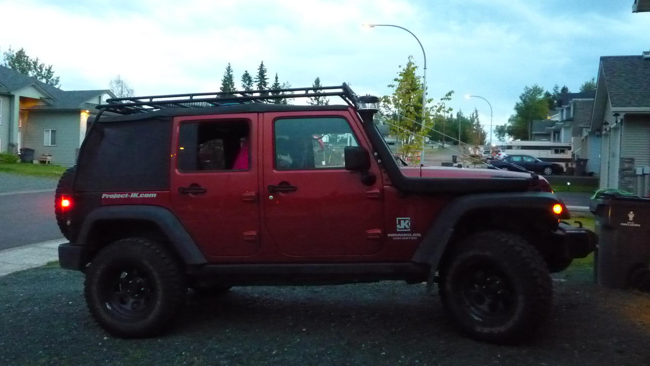

Smmmmooootthhhhh bolt up with the AEV snorkel today. Fits great with the Gobi and works with KC windshield brackets also.
Originally Posted by Cedo Nulli
Good poser pic of the rack with AEV Snorkel and windshield lights.
Really impressed with how well all three of these items fit together.
Well I'm glad to report that the Gobi will work with the AEV pre filter as well. I heard that MCCURDY had to extend his spout to get the pre filter to fit. AEV makes the snorkel a little longer now and the prefilter fits perfect. Pics below.

Hey Northern Wrangler what are the cables from the hood latches to your gobi rack for?
Old Aug 27, 2010 | 06:16 AM
  #533
Cedo Nulli's Avatar
Joined: Mar 2009
Posts: 1,102
From: Beachside, FL
Those look like a set of brush risers to me...and an excellent addition! Keeps branches, etc off the hood/windshield and raises them up and over the Jeep.
I've made some out of 550 cord for some trails before, but his cable ones look good.
Good info -- thanks. I did have to modify mine, but I had one of the initial batch, so it's good to know the current ones are in fact shipping with the extended piece included.
