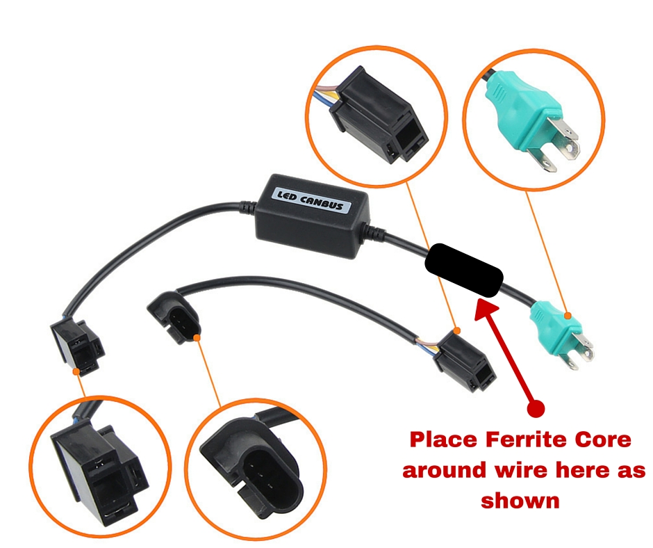

Update on the radio interference - We spent some time testing today and had a lot of success in eliminating the radio interference with the use of 7mm Ferrite Cores attached the wires. We placed the clip-on ferrite cores around the anti-flicker wiring after the Canbus and around 90% of the radio interference was eliminated. We had no problems listening to any radio stations in range with the ferrite cores installed. For those interested, you can pick up some 7mm Ferrite Cores on Amazon here for around $5. We're planning to start including these with each set in the very near future.

Has someone looked at these with a spectrum analyzer to see what frequencies this interference is occurring? I saw someone mention terrestrial FM radio (88-108 MHz) but as an amateur radio operator and scanner user I think a closer look may be in order to ensure you're FCC compliant.

Can you provide a picture of this? I want to make sure I place it around the correct wiring. Does it go around the entire black canbus wire? And does after mean, after canbus headed to light or vice versa?

I've attached a picture to help you with placement. Hope this helps clear things up.
Name:	Place Ferrite Core around wire here.jpg
