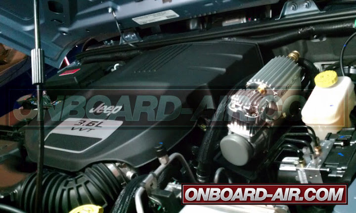

We have a few customers that purchased the 2012 ADA kit, and am waiting to get pictures. I will check and see if I can get some for you. It is a tight fit on the 2012, but it works.
The 2on2 won't be available for the 2012, because there just isn't room between the radiator and the new engine like the previous years.

Old May 5, 2012 | 12:01 PM
Air Werkz's Avatar
Former Vendor
Posts: 242
From: Arizona
Here is a picture from one of our customer of the ADA system on a 2012 JK.
