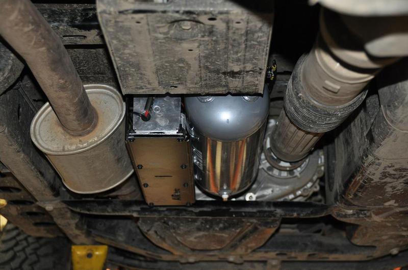

When I first installed this system I got quite a bit of vibration and noise from where the bracket touched a floor pan cross-member (2012 JKUR). To eliminate that I picked up some big rubber washers at the hardware store. They look like fender washers. I put (4) of them between the bracket and the jeep body mounting points to get some isolation and a little gap at the cross member. It went from feeling like one of those vibrating beds to hardly noticeable, and I can barely hear it run if I'm driving down the road. I'd highly recommend everyone pick some of those up before your install.

In the first pic, you can see my bracket was a little askew, making the compressors contact the tank when I hit some rough road. I reefed on it some and was able to get some clearance, so now it doesn't make contact. It also looks like its close to the muffler, but that's just the point of view. There is enough clearance.

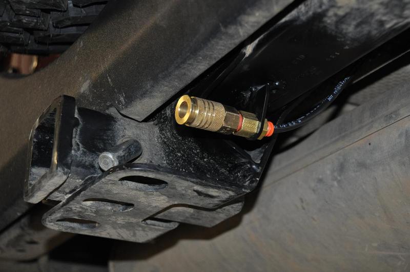

For the air disconnect, I picked up a rubber 7/8" rubber bumper meant for canes (not shown). It slips snuggly on the air disconnect to keep debri and water out. I'll try to take a pic of that, as well as where I mounted my filters, when I get a chance.

I'll see if I can post a couple pics of my installation:
