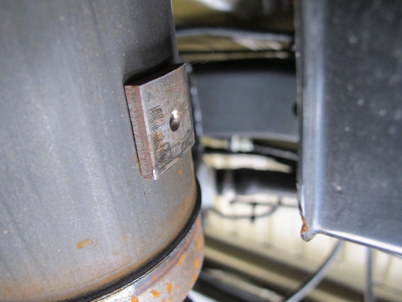

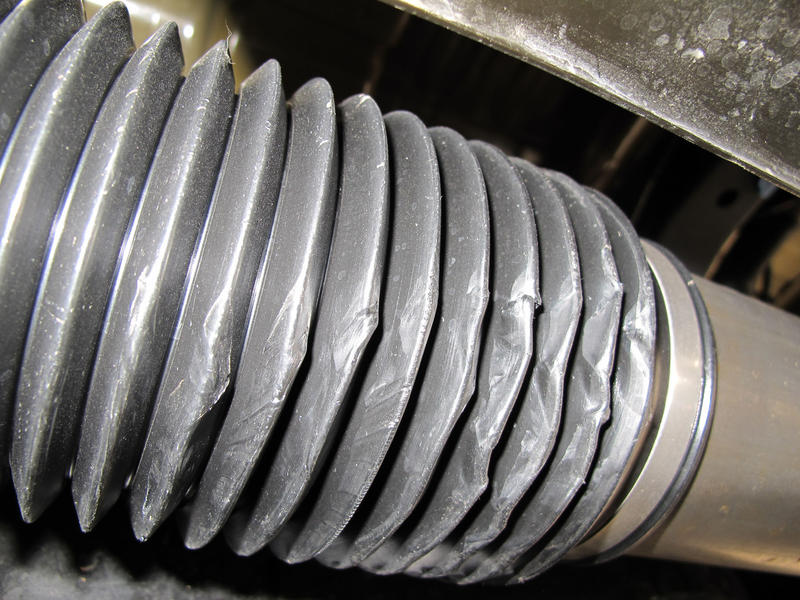

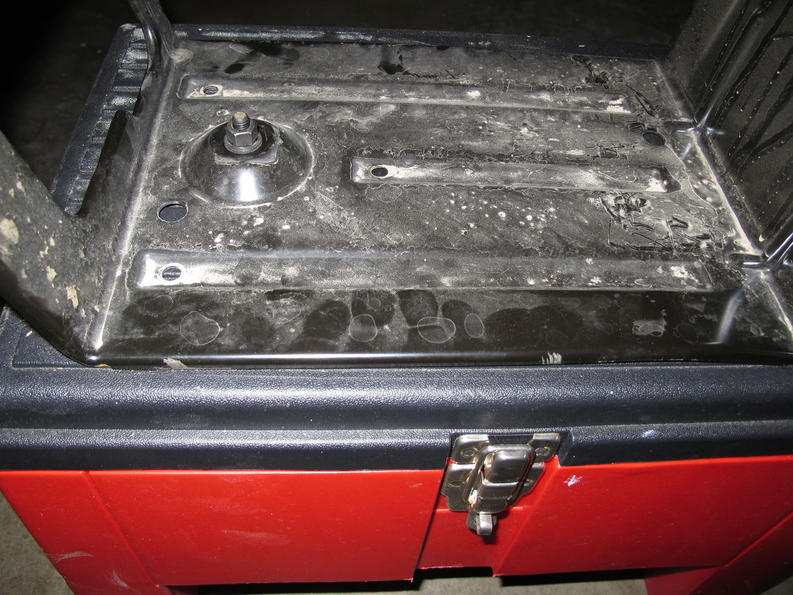

i installed my poison spyder evap skid today. first the reason - my driveshaft hit the skid on a recent run and damaged the driveshaft boot, the driveshaft weights and boot metal collar scraped the skid. you can see the two spots where the paint is scraped off of the edge of the skid. here are those pictures:

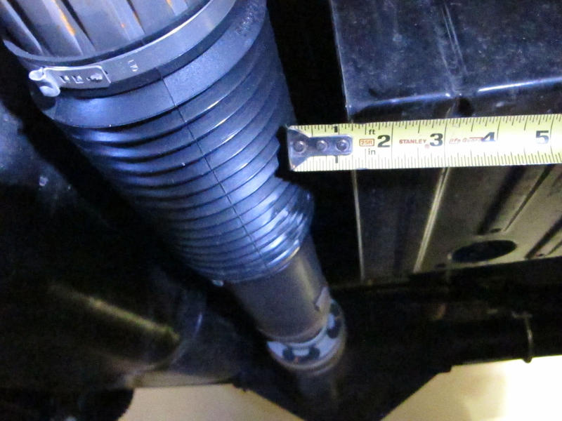

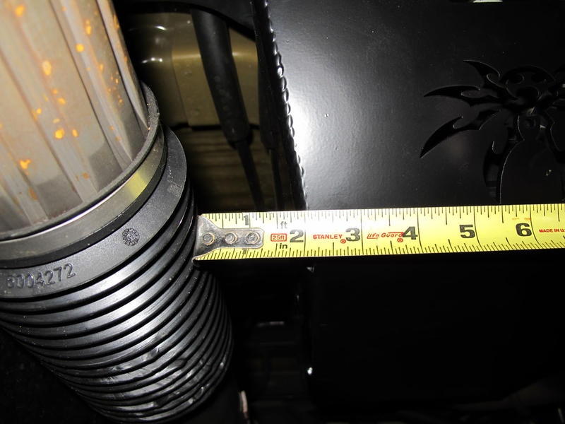

the ps skid gives me 2" clearance to the driveshaft boot, the stock mopar skid clearance was 1-3/16". from the damage, i think that's enough to prevent the problem. the ps skid is further away from the driveshaft than the gas tank skid is, distance from the boot to the gas tank skid is about 1-3/4". here are those pictures:
