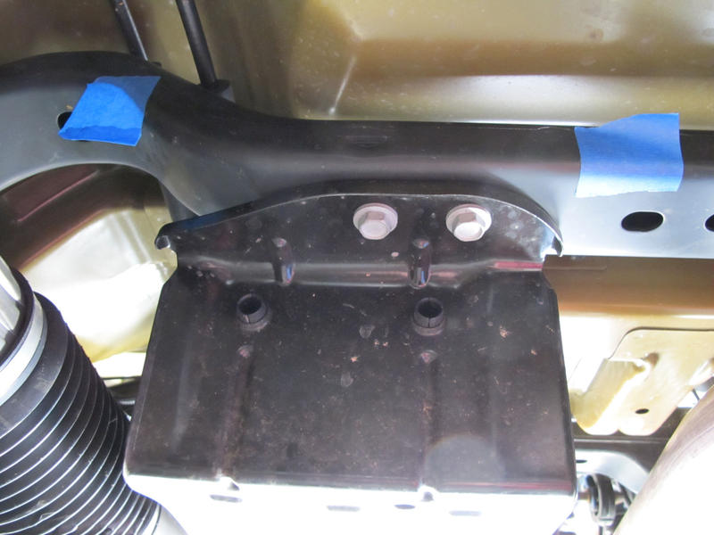

thought about this some more. don't know if the 2012 cannister has a metal nut in it on the bottom where the bolt on the bottom of the 2012 skid screws in or not. if it's just plastic, might still be an issue on how hard to tighten it. the other thing is the 2012 cannister has two round protrusions that slip into the front of the stock skid to keep it from rotating like in this picture.

probably either the protrusions or the cannister itself need to be close to or touching the psc skid front to keep the cannister from rotatiing with only the bolt attaching to it from below.
