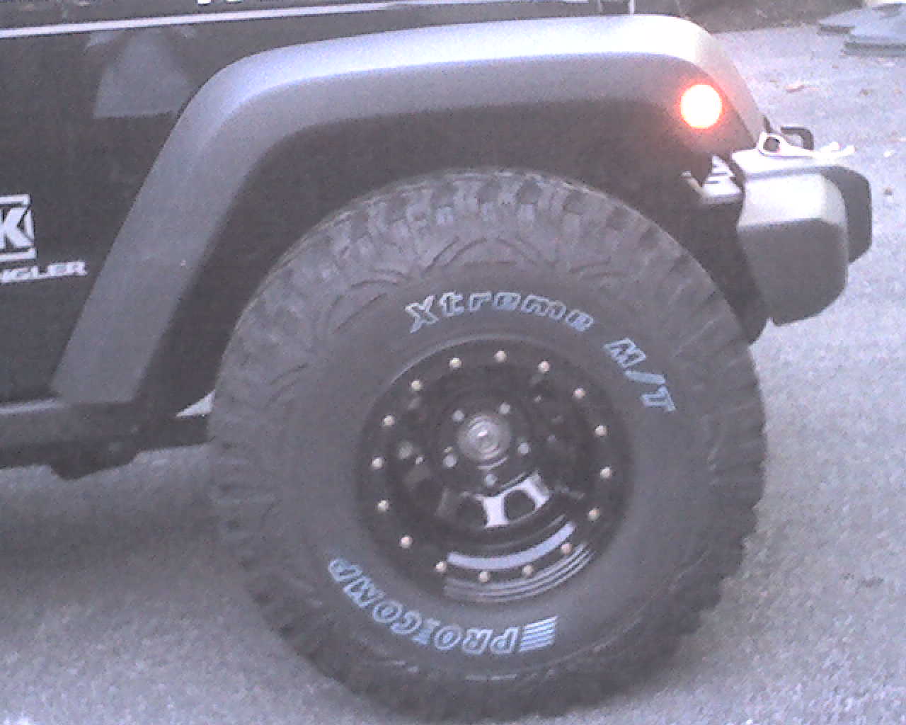

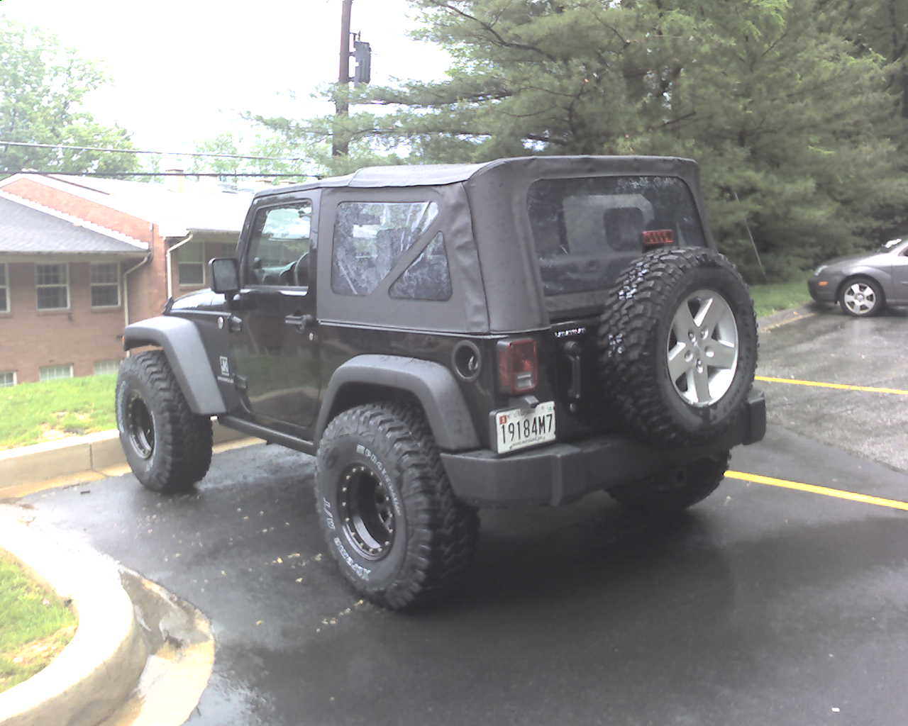

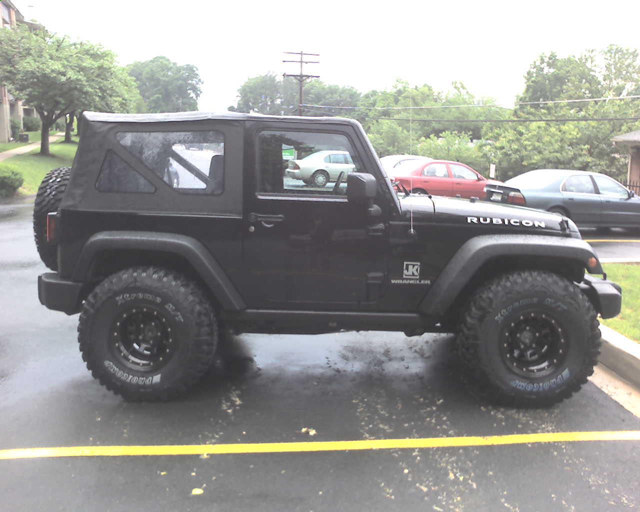

I ran 35's on a stock Rubicon for one day and it was awful, I couldn't really turn and it rubbed the Front bumper something awful. The only reason I did it was so I didn't have to bring both sets of wheels up to the shop when I was doing my lift.
The wheels I was on were 3.75 Back spaced which made them stick out real far. If you do this with stock wheels or anything close to them u will need spacers or u will be going straight all the time. a 1" body will help you out. Ill attach a picture of my jeep stock with 35's.
I knew these pics would help someone out at some point on this Forum

Thanks those pics definetly help....think i may just get enough to run 35's for now....until i can afford THE end all be all lift
