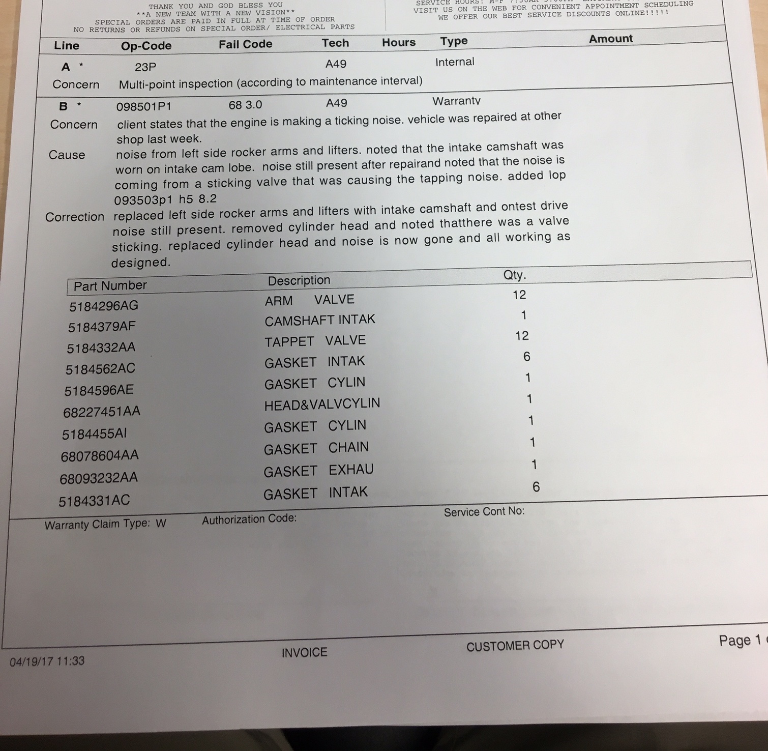

I just picked it up from the dealer. It is running perfectly quiet now. According to the service ticket, the noise was coming from a sticking valve. I have added a photo of the service ticket in case that helps anyone.

2014 JKU started ticking around 95K. Also had the no heat issue so I figured I'd knock both out on one visit. Dealer ended up shot gunning it by replacing all the rockers, all the lash adjusters and all the cams. That fixed it. LoL! Did the heater core, radiator and a valve as well as a flush. Heat fixed. Thank god for the unlimited mileage lifetime bumper to bumper warranty. That would have been expensive.
