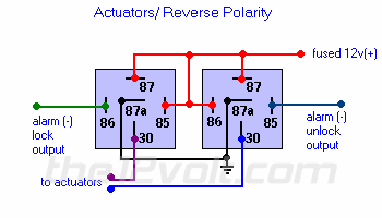

I never did find the correct molex connector and I had no interest in buying the body harness. I wound up cutting the connectors off the new door harnesses I bought and soldering the old ones back on to mate up with the existing body harness. (You do need the door harness to connect to the locks.) For the locks, I just used some blade type quick disconnects and ran 2 conductor wire from each body side molex location to the relay pack in the front (see below) and tied that into my remote start.
As for connection to an alarm, remote start or keyless module, most of those are a negative or positive pulse output. The OEM locks are reverse polarity so you have to build a relay pack to connect them. It's actually a lot easier than it sounds:
