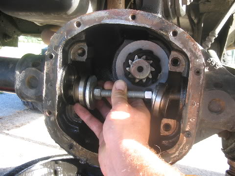

Old Sep 20, 2013 | 03:37 PM
jeeperjkjeeper's Avatar
Posts: 1,891
Likes: 5
From: Great Lakes
use a 12" pc of threaded rod, a few nuts on the rod and about 4 large washers that must be over 2" in diameter....2.25 or slightly larger is perfect.....use an open end wrench on the nuts to drive the washers outward to press the seals in.
Old Sep 20, 2013 | 03:50 PM
dave nelson's Avatar
Joined: Nov 2009
Posts: 495
From: Altadena, CA
Originally Posted by jeeperjkjeeper
<img src="https://www.jk-forum.com/forums/attachment.php?attachmentid=499059"/>
Wow, that as an absolutely perfect solution. That's the first I've heard of that method. Thanks so much for sharing, this is definitely how I'm going to do it tomorrow.

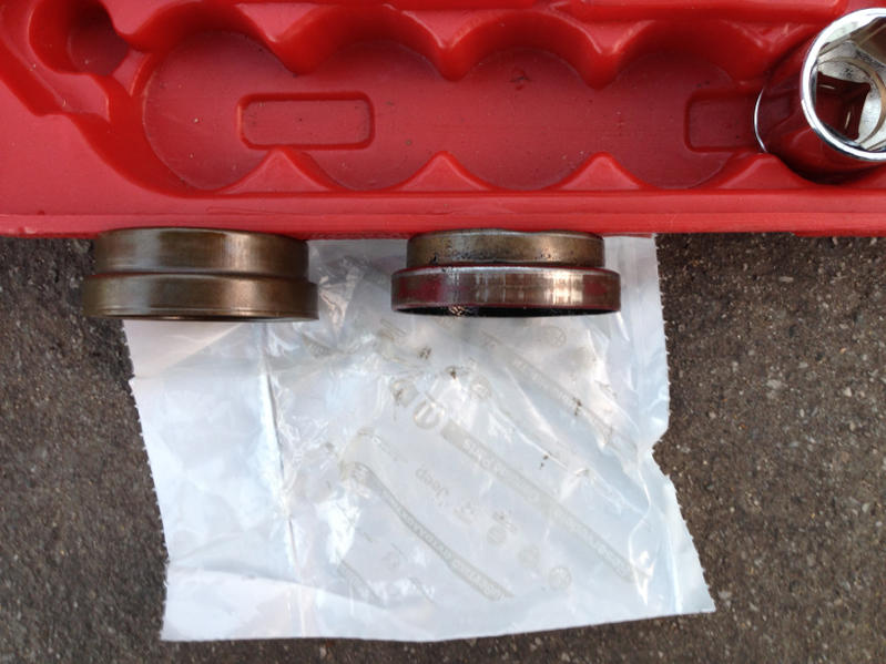

Thanks all. I spent the entire day working on this, and finally finished. Wow that was rough, but a good learning experience.
Oh, and something is now wrong and my front locker (stock Rubi one) won't engage, arghhhh.
Interesting though, the failed axle seal was incredibly easy to push out into the carrier with a single tap with a metal rod and hammer. The other one (which I wanted to replace just in case) took a ton of bashing to get out. Eventually trimming a sharp v-notch in the metal rod helped, but didn't quite get it out. The trick was wrapping the end of the rod in a ton of shop towels. Weird, but it somehow worked.
Check out the Yukon seals (right) I pulled out compared to the Mopar (left) ones. Interesting how the Yukons are so narrow... Easier to install I suppose?
