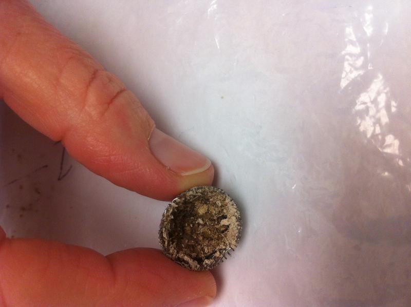

Here is my situation. I have a 2010 Rubicon with 30K miles now. I had about 25-26K miles on it when the heater out put was ranging from 68deg F to 178 deg F on max heat and max blower. The temp would vary quite a bit from time to time and from vent to vent. The temp would vary from time to time in the same vent. It was generally hotter on the right side and would get colder on the left side. At first I thought it was the blending doors not operating properly. I took it into the dealership (still under warranty) and they found casting sand in the cooling system. Apparently when the engine was casted all the sand had not been removed. It has been to the dealership 4 times now and is still not fixed. They have flushed the system MANY times, replaced the radiator and put in a new short block. Yes a new engine! The thing is they did not do all of it at one time. They flushed it every time, but one time they replaced the radiator and scraped the fine sand off the freeze plugs. I would get it back and put several hundred miles on it and the problem would come back up. Then they replace the heater core. After several hundred more miles the engine was replace and the new radiator flushed. I asked for everything that the antifreeze touched to be replaced at one time. I understand that Chrysler would not allow the dealership to do this. They put an inline screen in the heater return hose just up stream from the thermostat. This thing looks almost like the screen/washer that is in the hose in the back of residential clothes washing machines; however it is a MOPAR part. This screen would plug up with sand all the time. I saw the sand that was pulled out of the cooling system.

thank you for your responce. I can see what you’re saying. Normally i drive back and forth to work which is about 25 miles one way. So the motor is running (most of the time ) 40 min at a time then it cools down. I started having the problem when i took the jeep on 4 day trip. It was a 12 - 13 hour drive in one day. One day i did very little driving but the following day the jeep stayed hot (did not have it running all the time ) for 10 ish hrs. I then drove the 12 + hrs back on the 4th day. This would have allowed the chemicals to break down under heat over time. However please look and this picture of the screen that a tech from the dealership is holding.it showes the screen full of “sand”. Does this look like a break down of protective properties or casting sand? The subsance that was removed from the freeze plugs was more like clay.
