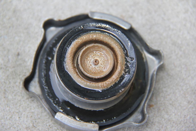

Originally Posted by tomlennon
I wanted to share this with you guys - some evidence - that this is a problem with this engine and model year. I have a 2010 JKU, 29k miles (mostly on-road, I've never forded any water), original owner. My heater has been slowly dying - it used to blow so hot it'd melt your face off - now I'm lucky if the car warms up in 45 minutes.
I've seen the posts about there possibly being sand in the radiators, left over from the casting process. I popped my cap off yesterday, hoping to maybe work some air out of the lines, but I stopped after I looked at the bottom of the cap. It's covered in SAND! Check it out:

That really doesn't look like casting sand, looks more like minerals coming out of the coolant. I've seen this goo before in other vehicles, but not to the degree that you're seeing it. I'd completely drain and flush the system then fill it up with just plain distilled water and run it like that for a few days if the weather is cool, but not freezing, and see if you're still getting sand.

I doubt its casting sand. I work in an aluminum foundry, casting heads for trickflow. Casting sand is extremely fine sand. After its cast the cores are rattled out of the casting, then the kalpurs are cut off (draw tubes for when its cooling) its blown out with high pressure air then it goes into a heat age process when it comes out its dipped in a water quench. Its then put in a tumbler and shot blasted then machined. I personally don't think that its casting sand. Just my opinion though. All the heat pretty much breaks down the catalyst in the sand holding it together and it just falls out or is blown out. It would have to be alot of sand in there to clog stuff up and I can't see that happening.
