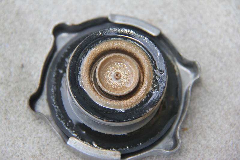

Exclamation 2010 JKU: No heat, and sand in my radiator
I wanted to share this with you guys - some evidence - that this is a problem with this engine and model year. I have a 2010 JKU, 29k miles (mostly on-road, I've never forded any water), original owner. My heater has been slowly dying - it used to blow so hot it'd melt your face off - now I'm lucky if the car warms up in 45 minutes.
I've seen the posts about there possibly being sand in the radiators, left over from the casting process. I popped my cap off yesterday, hoping to maybe work some air out of the lines, but I stopped after I looked at the bottom of the cap. It's covered in SAND! Check it out:

My vehicle is under warranty - I'm not sweating too much - but aside from the heating core - what did they need to replace, and why?

Y'all can try a coolant filter. The 6.0 ford diesel had this problem and guys starting using a coolant filter setup. I would post a link, but it's to a non-sponsor and I'm too new to get in trouble. Google coolant filter and you'll see what I'm talking about. Best of luck.
