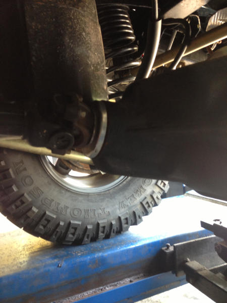

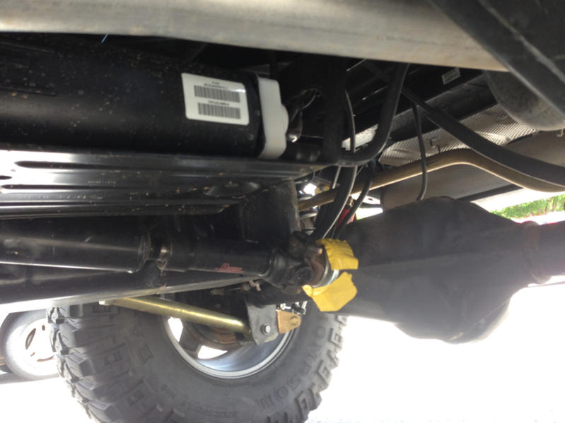

I had a clicking noise that turned into a whine at my rear diff. Started only at slow speeds then elevated to constant. Mine was the dust shield on the drive shaft. Might be something to check.

Mattgt5 this is why this place rocks, great idea, will check it thanks.
Makes sense as light load is applied to drive shaft might be enough to loosen it enough to waggle about.
