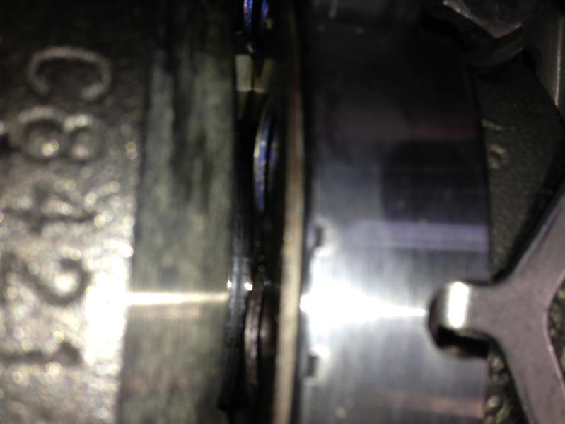

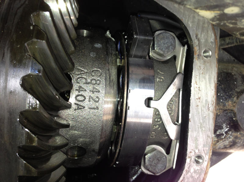

Drained diff, removed cover, used brake cleaner to rinse out interior and gears.
Lifted driver rear wheel off the ground, with passenger wheel just barely touching. Idea was if the diff was working properly the driver wheel should spin freely.
Well driver did not spin freely at all, any rotation of drivers caused passenger to equally turn in opposite direction.
Put in 4 lo and locked rear diff mo change, unlocked rear diff no change, albeit it likely need to be rotated a turn or two to engage and disengage, however jack set up etc did not allow me to mess around much.
Fluid removed was liquidy ( not sludge). Black but mot chocolate milk. Build up on drain plug magnet was minimal.
Letting silicone dry, then re-fill diff, then see who knows maybe a whole can o brake clean helped with flushing tiny debris out. Now to read rongenx great write up on rear diff n locker to understand its operation. Will report back what fresh fluid does for it.

Reading, thanks ronjenx you are a very appreciated poster !
I would say my rear locker is jammed up.
First two pics are my rear end, third is thanks to ronjenx !
