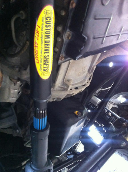

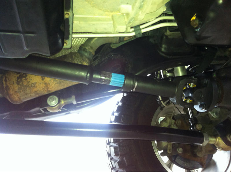

Took about 3 hours to install....1 of those hours was spent driving to NAPA to get a 1 1/4 socket to remove the OEM transfer case input flange nut.....so in all about two hours.....of which the last hour was spent working in a souther La down pour...but I was running out of daylight so I had to take an amphibious approach.. :-)
Off with the old
On with the new
JK wood...!!

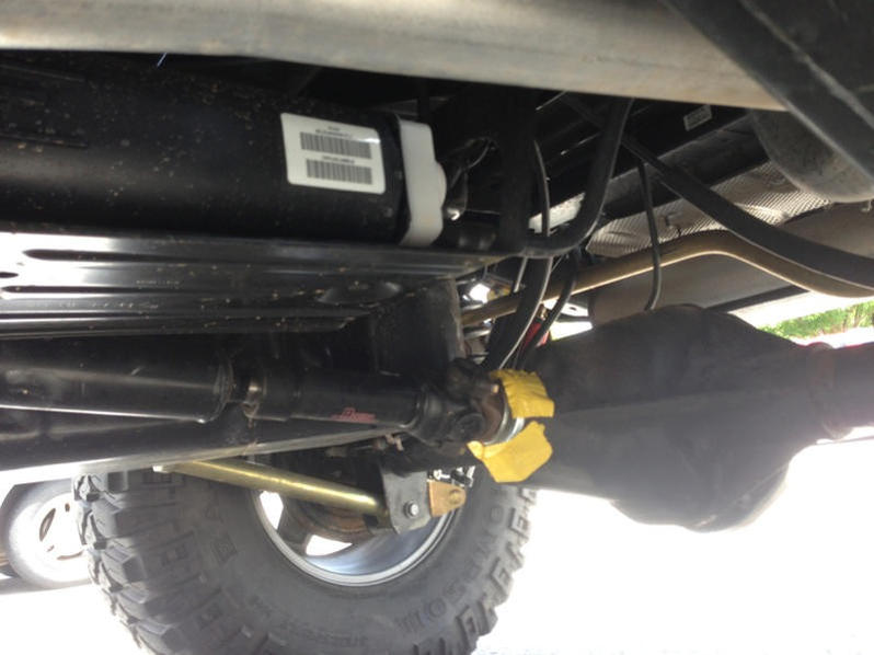

  #28
Marmot mb's Avatar
Joined: Jun 2008
Posts: 143
From: AB

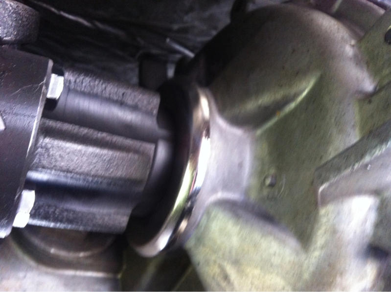

Take a look at your old output shaft, there is a dust /debris sheild to protect the bearing seal.
My new output shaft did not have the dust sheild, tech said i could buy an oem output yoke and take the dust sheild off and then spot weld it in place around the new one.
I think he wrecked the old one getting it off. Im thinking put some silicone there to protect the seal from grit, rocks, trail pokey things.
See yellow tape area

Old Sep 10, 2013 | 06:06 PM
  #29
EasyRunGents's Avatar
Posts: 35
From: Baton Rouge, Louisiana
Oh ok man...my TW output flange and input yoke both had shields on them.

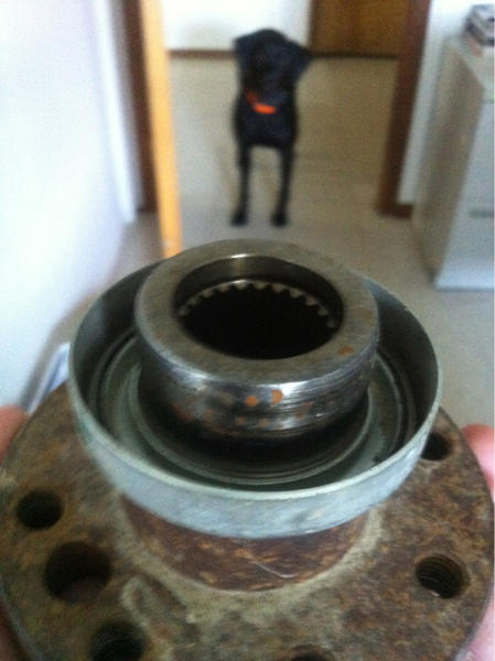

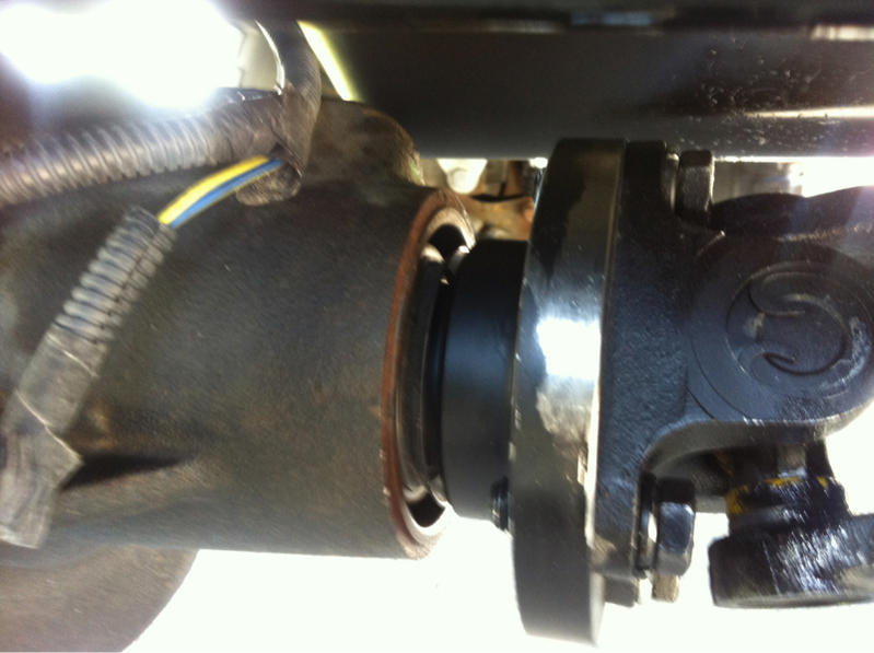

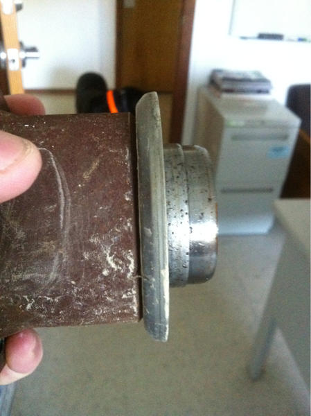

OEM front flange
There is what looks to be a shield or guard attached to the flange. It doesn't seal so I cant see it protecting from anything other than debris being forced into the seal.
TW front flange
Doesn't appear to have the same or any sort of protective shield like the OEM unit. I looked at the TW website and the instruction sheet that was delivered with the DS and there is no mention of using the OEM shield or an upgrade option...so I guess I will put blind faith in TW that if they don't suggest a fix or address the issue...I am good.
OEM transfer case input, which has what appears to be a protective shield.
TW transfer case input yoke, which has what appears to be a protective shield.
Maybe direction of travel has something to do with it...?
