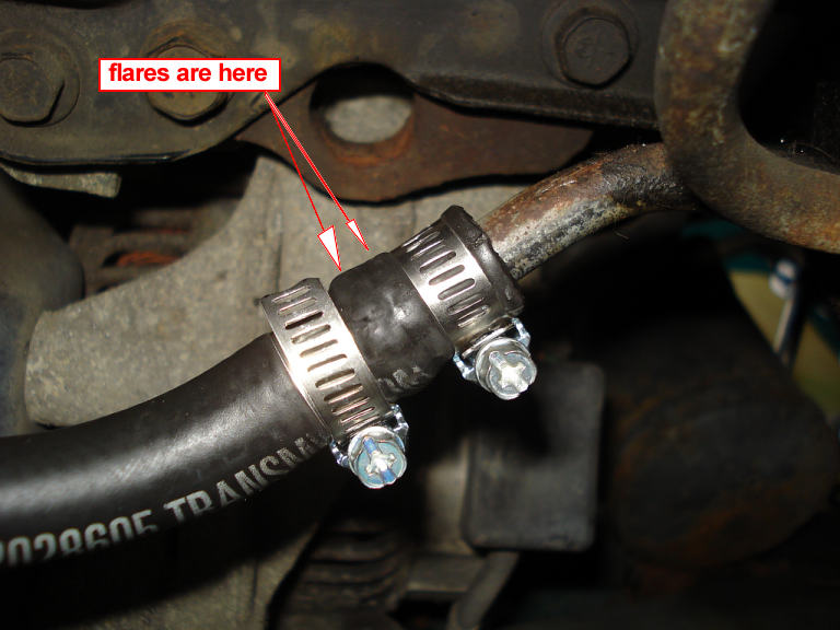

I think I will either remove the sleeve or just cut the pipe off above the sleeve and put hose clamps on as shown in the pics below.

I'm taking it in tomorrow for the trans connectors leaking, engine oil and coolant leaks as well (70,000kms on it btw). I definitely wouldnt pay $600 for the repair. I found some T-bolt hose clamps which have a higher clamp force then screw type clamps so that's the route I will take if out of warranty.
