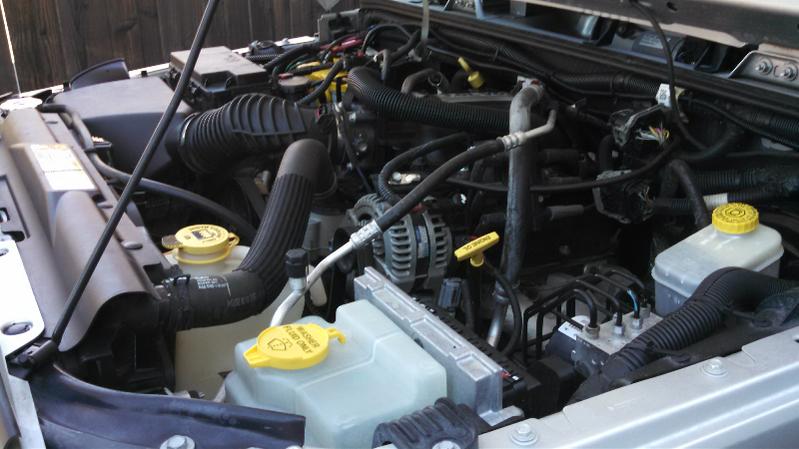

Old Jul 27, 2014 | 05:06 PM
gunbo75's Avatar
Posts: 1,456
From: Pleasant Hill Ca.
Simple green it works
See.

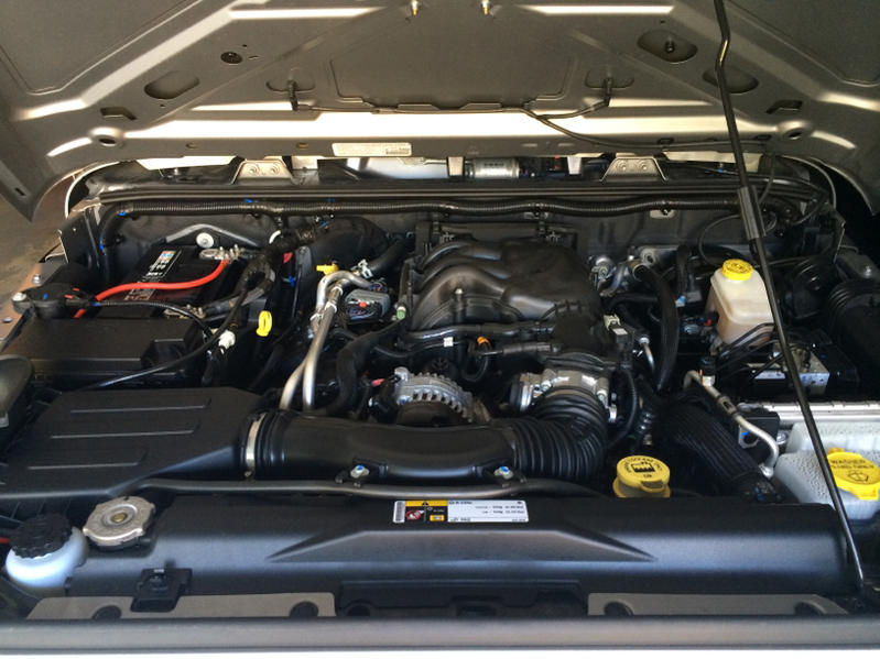

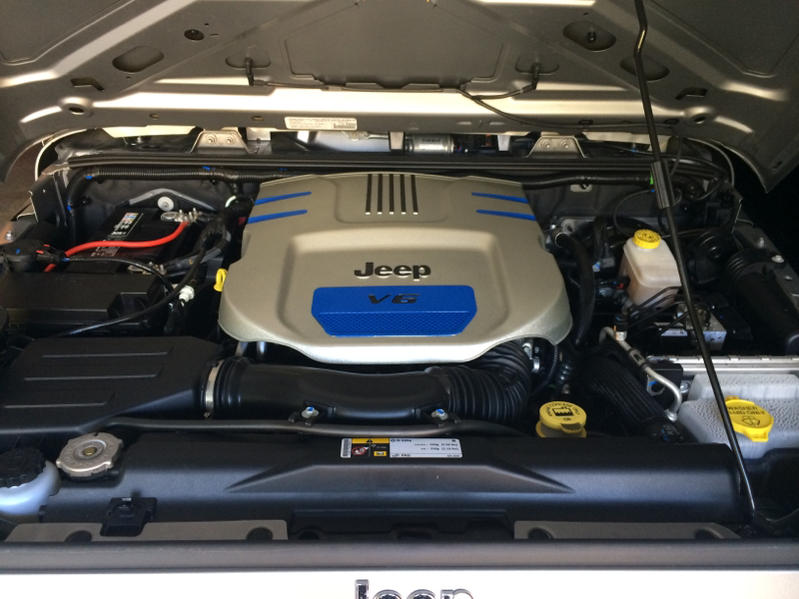

Old Aug 8, 2014 | 06:52 PM
zim31's Avatar
Joined: Aug 2013
Posts: 45
From: Texas
I have found that if you wash it often enough it stays very clean. I just give mine a quick wash whenever I wash the jeep. She's stayed pretty clean.
