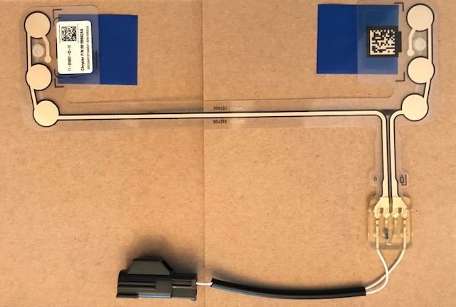

There's a thread that shows how to cut the warmer safely around the seat occupancy sensor. I need to do it, I'm just not in a hurry.
Don't worry about cutting the heat pad around the occupancy sensor - the occupancy sensor sits on top of the heater pad.
Both the heater pads and the occupancy sensor have adhesive strips on them to hold them in place - so be careful if you are gonna remove either of them.
Here are what the factory heating pads look like (2016 JK)
Here is the what the occupancy sensor looks like.
