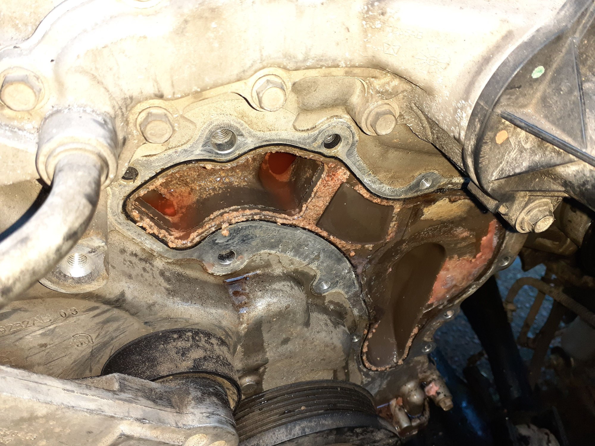

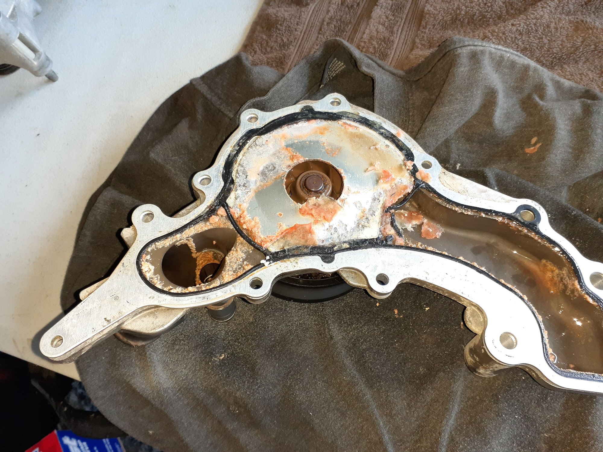

I own a 2013 JK with the dreaded cool air on drivers side. I did the heater core swap by way of cutting. I used an oscillating saw on the cuts which made it super easy. It took me about an hour. Next time will be about 15 min.
Note: I only had to cut the lower bracket and was able to pull the upper bracket outward slightly to slide the heater core out keeping the integrity of the upper bracket. I haven't noticed anything negative from doing the cut method. Everything went back together just fine and is very solid.
I had great heat after the replacement but over about 2 months has started getting cool again.
Before the initial replacement I did have sand sitting at the bottom of the overflow tank.
Most recently my water pump went out and when I pulled the water pump I found heavy sand build up in the water pump and in the cavity behind the water pump. Confirming my suspicion of casting sand clogging the HC. (Pics below)
I've owned the jeep four about 8 months and it has 75,000 miles. My guess is this issue has never been dealt with on this Jeep.
I'm actually looking forward to changing the heater core again mostly because I can't stand the thought of that sand being in there. And of course I want heat again.
Thanks to this thread I will be looking into a coolant filter.
Old Water pump
Cavity behind water pump
Cavity after cleanup
