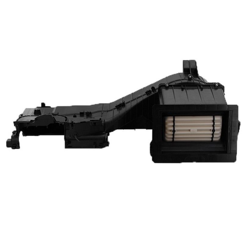

Could my heat be affected by my broken vent circulator (I broke it replacing air filter)? I had the heater core replaced two years ago, and had the system flushed again last year. I am getting warmish air on the drivers side, which I had experienced before I originally had the core replaced. I have yet to measure temps, but that is next on my list. The lack of extreme heat is most noticeable when temps are below 15 degrees. Any insight provided would be great. Thanks!

I'll be honest, I have no idea what a "vent circulator" is that you're describing. Could you post a pic of the broken part?

It's the part at the far right, which is either down or up, depending on if you want air recirculation from inside the vehicle, or air from outside the vehicle. I broke it when I was replacing the cabin air filter, and not it is always 'down' or bringing in air from the outside. I am wondering if this is another factor in the heat temp.

Thanks, not what I had originally envisioned, you probably use the correct technical name, I call that the thinga-ma-jig, connected to the what-cha-ma-call-it with the flapper that controls re-circulate on/off airflow. If the flap is just stuck in the non re-circulate position, I don't believe it will have that much of an impact like you are describing. I took my vent temp measurements with re-circulate off and hardly ever run my heat with re-circulate on, and the temps from my center vents are hot enough to start burning my hands if I hold them close for too long, even in those 7-15deg F temps we've been having.
